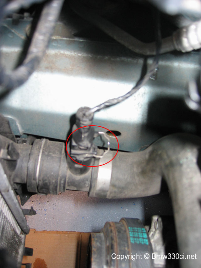

One thing to note, the sensor connector can be released by pushing the wire clip in. I discovered this recently. LOL. I used to move it out and some time it pops off and i loose them too.
http://www.bmw330ci.net/maintenance/...osetank015.jpg
