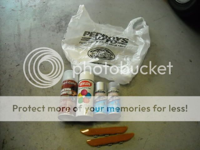

I ran over to Pepboys and here are the materials I used:
-1 can of Duplicolor Adhesion Promoter ($6)

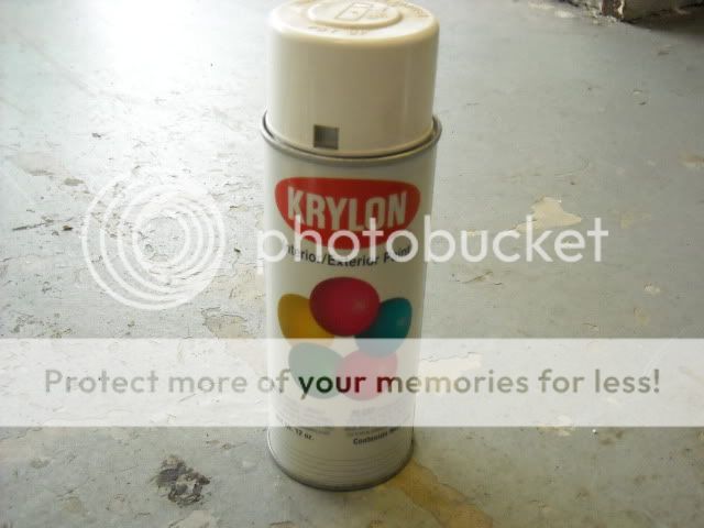

-1 can of White Primer (I had a bottle handy at my house but it shouldnt cost more than $2 at walmart)
-1 small can of DupliColor Auto Spray, color>"Radiant Silver Metalic" ($5)
-1 small can of DupliColor Auto Spray Clear Top Coat ($5)

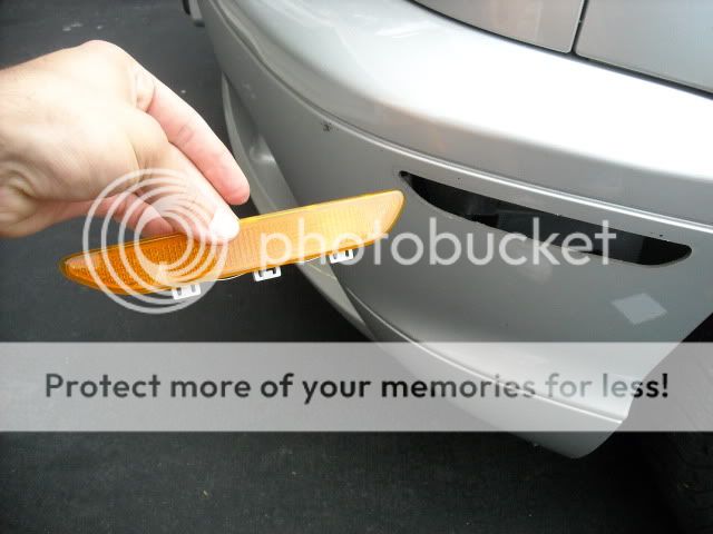

Step 1: Take the reflectors off the car. In my case I have a facelifted coupe so the reflectors are a bit different in size compared to other e46's but its the same idea. I used a credit card to get underneath the reflector and pry it out. Start from the top closest to the wheel.

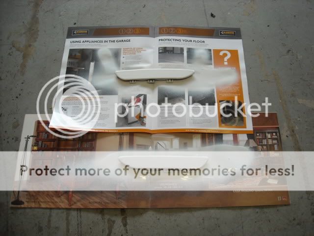

Step 3: Dry the pieces fully and lay them out on some old magazines or something. When spraying the reflectors I did each individually. The paint will smell so make sure you're in an open area.

Step 5: Apply about 3 coats of the white Primer. The white base coat will help keep the silver coat later on from getting too dark. This needs to completely cover the reflector. I sprayed one coat at about a 30 degree angle on each side of the reflector and then a coat from straight above. Let this dry fully, in my case it took a about 20 mins.

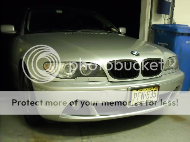

Heres the final result
Looks WAY better than it did before hand
