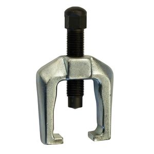

I know this is an old thread but, I thought I would share in case anyone else has the same problem. I had the same problem. Meyle HD control arms just don't have enough flex to get the strut out. Maybe oem or older control arms have enough flex. I had about 1 1/4 inches of strut left in the knuckle. I end up renting an arm puller for compact cars from Autozone to disconnect the control arm outer ball joint from the steering knuckle.
This is it:
I used it one I had already dropped the control arm as much as I could. Otherwise clearance between the top of this tool and the bottom of the strut becomes an issue.
