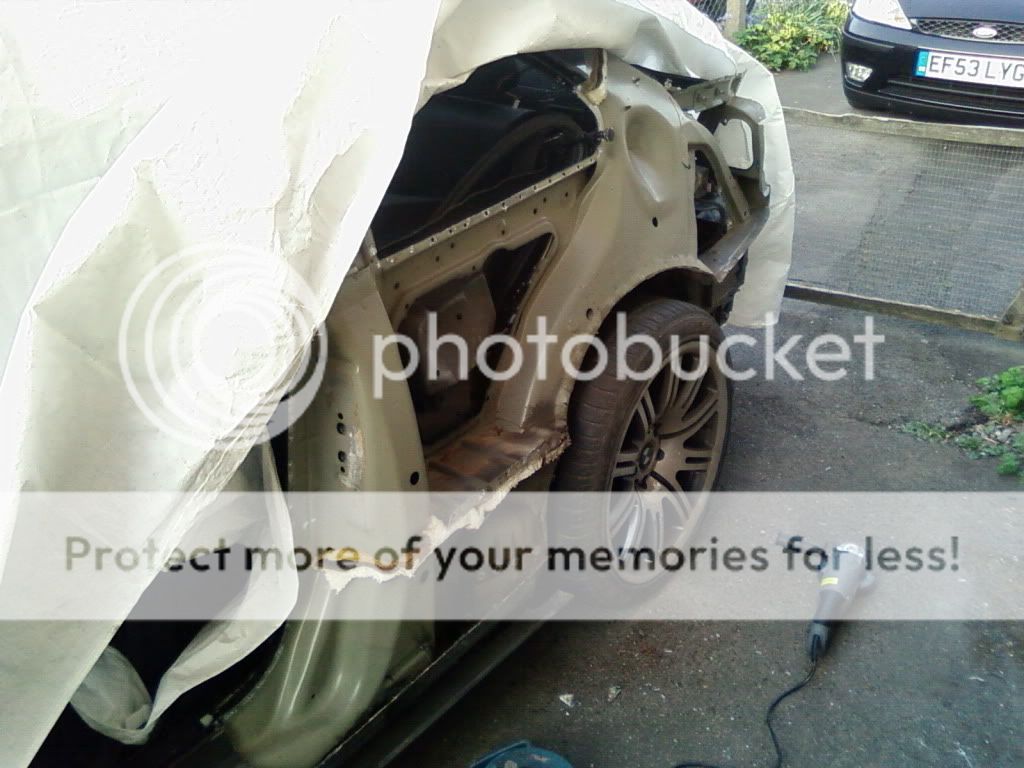

Hope they are of use, i went for changing the complete quarter panel as its the best way to get an OEM finish! this was time consuming and a bit of a pain to do in places but as long as you have a spot weld drill and some thin cutting discs its not too bad!
Before work started

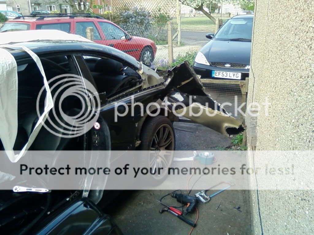

Strating to cut away the passenger quarter panel, its a bit fiddly as its brazed on in a few places (under the light cluster, and the bottom corner of the rear window)
The car looks a bit of a wreck now! but it has to get worse to get better!

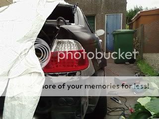

This was doing the drivers side, i managed to get a second hand brand new panel from a garage which bought it in for an insurance repair job on a real M3, all they done was cut a section out by the light! so I stripped the paint of the original panel and cut to fit flush, and seam welded, with a bit of patients it came out perfect!
after welding, pre prep work before spraying.
