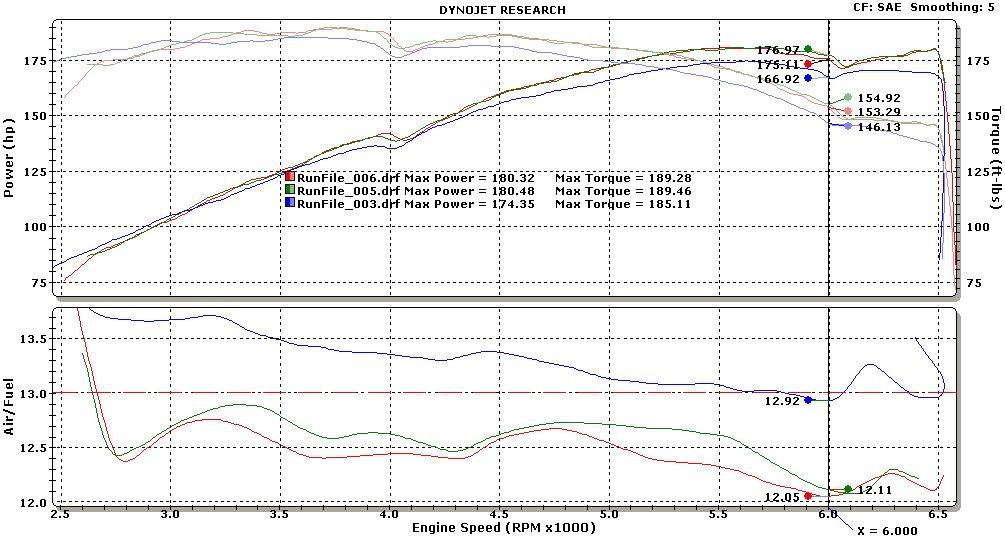

My goal here is not to squeeze every possible HP from my engine with an AFC, after all, this will only take care of air/fuel tuning. But given how much richer my engine is running after the headers, Im sure I'll see a benefit from a/f tuning alone. On the richest spot which for my was 6000rpm, stock was at 12.92:1, with headers it was 12.05:1. There would be a few horses to be had there by just taking it up in the 13.1-13.3:1 range. I would have to sit on the dyno for some time to really see what a/f this engine likes best.
The dyno here shows the best baseline run Vs 2 of my headers dyno runs. I blew up the air/fuel box to get a closer look at the change...
