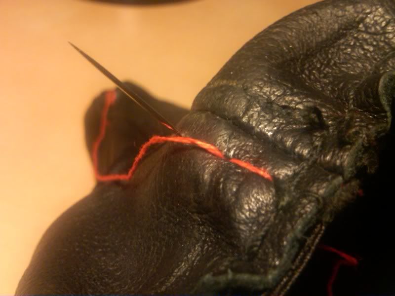

Thread the needle
Start at the top. Remember to start with the right color. Go in and out to make a loop on the inside of the boot.
Loop!
Extend the thread down to the bottom first stitch. .
Go into the first stitch. Note: try your best to use the existing holes to re-stitch
Now. This is the Tricky part. What you want to do is pull the thread through the boot, over the extend thread on the outside and back down the same hole you went up through. This will pull the outside extended thread down. Repeat all the way to the top. Tighten every 2-3 stitches by giving the thread a good pull. Take your time
Once you got all the way to the top, use the loop you made a few steps back to tie the thread together nice and tight.
This is what it should look like.
Do the same process for the other side. Start at the top and make a loop on the inside of the boot.
Extend the thread to the first hole near the bottom
Repeat steps to stitch: pull the thread through the boot, over the extend thread on the outside and back down the same hole you went up through. This will pull the outside extended thread down. Repeat all the way to the top. Tighten every 2-3 stitches by giving the thread a good pull. Take your time. Don't forget to tie a knot at the end using the loop you made a few steps back
