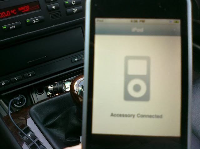

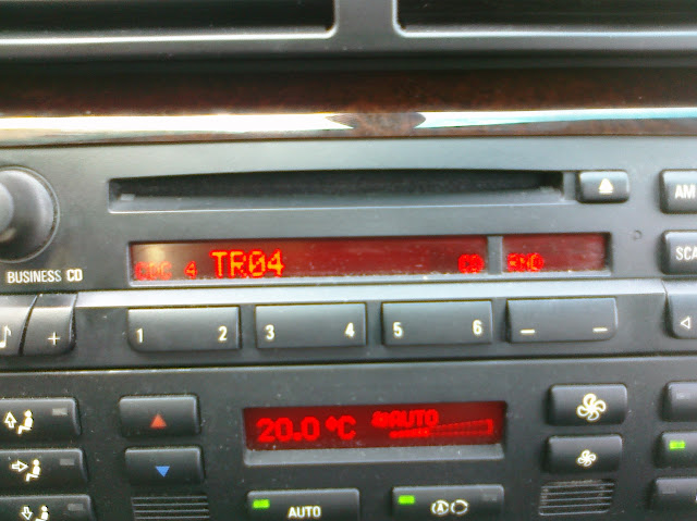

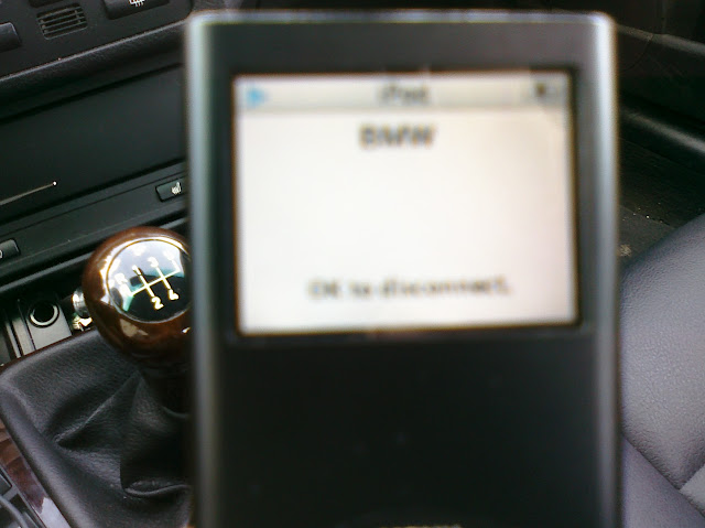

Very frustrating.... to eliminate iPod as the issue, I tried two (pics below) as well as the HU display (TRXX vs. the display text that showed before briefly recycling power to the HU yesterday)
Any other suggestions prior to a battery pull (which would be disappointing and the first "kink" in the otherwise great PA-12) ??

HU Display (sans display text)

iPod #1 (synced- "BMW")
iPod #2 (synced)
