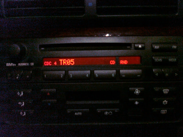

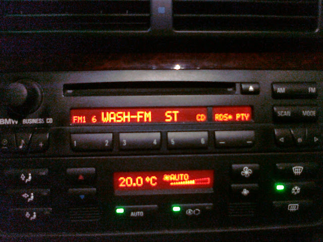

Here are pics of radio mode (which shows that display text works for AM/FM, which is why I haven't eliminate PA-12 as the issue) and CDC mode (which used to display MP3 text perfectly)
Radio Mode (w/ display-text)
CD-changer mode/PA-12 (display-text stopped working)

From your pics your dash matches mind. The CD soft button is also lit up over button 6. That should not be there.
