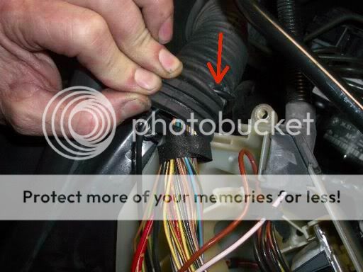

I ran the camera wires up from under the headlight, along the inner fender to the DME housing, in thru a little grommet, and snipped a small hole in the main harness boot, stretching the hole to feed the AV connector thru. and out into the DME / electrical case.
Next I located the white plastic mount on the fire wall. an easy place to feed the cable thru to the under dash area.
See the red arrow.

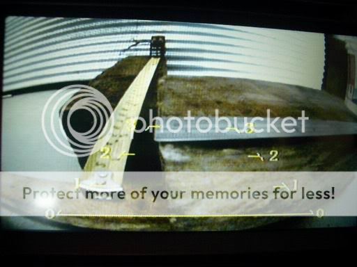

And in this shot the car is 18" from my workshop wall, the block of wood is low enough to just clear my splitter, but just flush to the tip of the splitter. the image is in reverse, and the fish eye effect makes it hard to judge at first.
