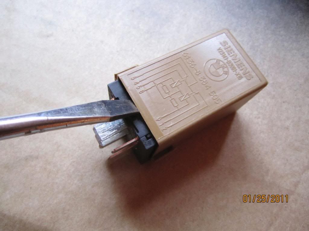

Once you get the relay out, there are two tabs on the bottom that you can pry the relay out of its casing.

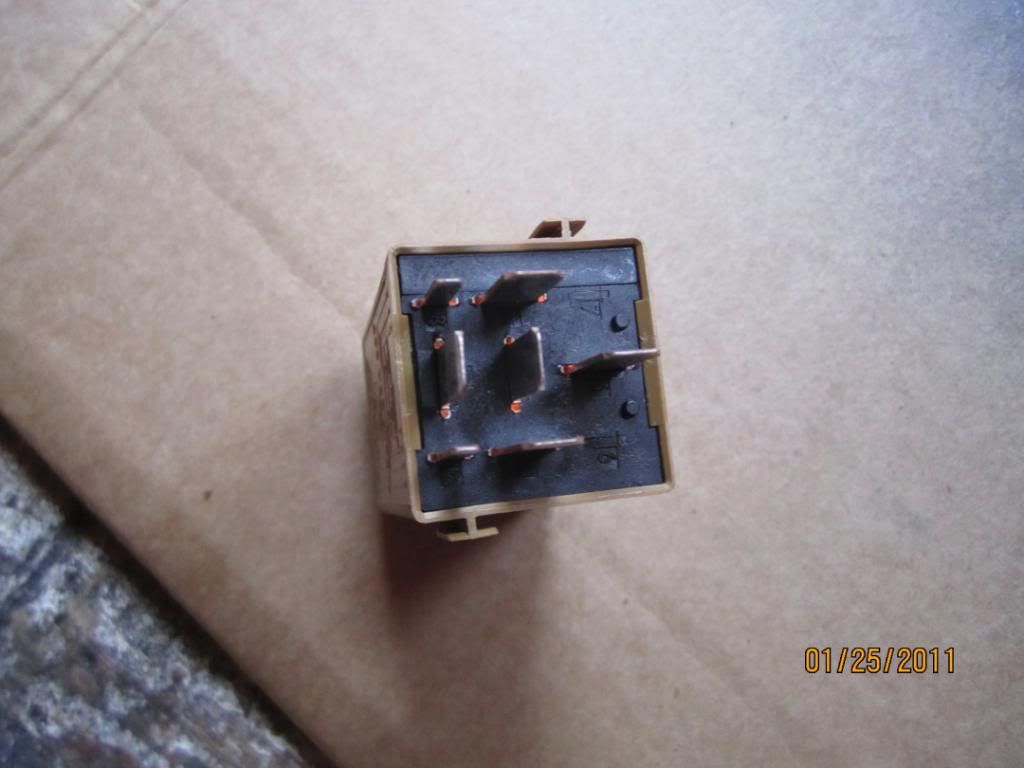

Now you got the relay out of its casing, you can examine its contents.
The main area of interest (and main failure spot) is the bottom relay closest to the pins. This relay is what turns on/off the wipers. Especially on older vehicles, and wet climates where wipers are used often, Oxidation builds up between the contact due to the constant spark between these points. It builds up so much that it blocks the signal and your wipers dont work. All I did was clean the contacts with a bit of sandpaper to remove the oxidation.
Get some sandpaper in there to brush the oxidation off the contacts
Voila! pop the cover back on the relay, reinstall, and your intermittent wiper problem should be solved. Mine work as good as new, and its been raining heavily!
