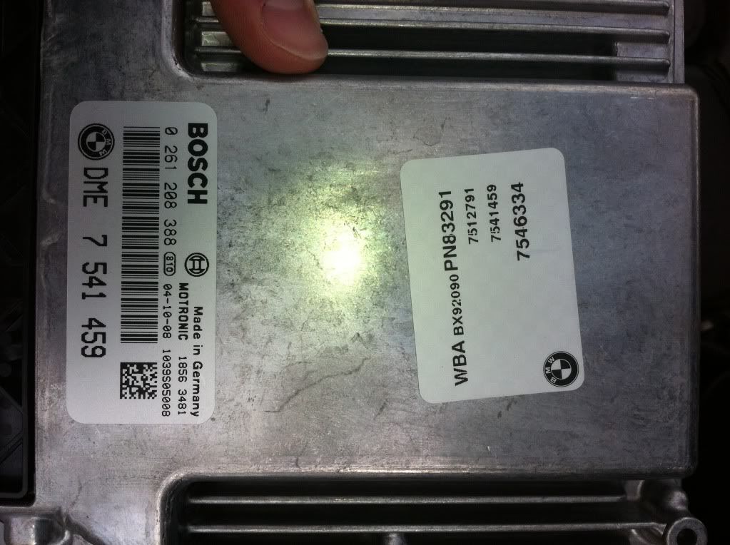

I have the N46 engine. This is the DME module:
Yes the connector with the blue dot does come apart. I have already inspected it because I found this information on the DME module:
http://tis.spaghetticoder.org/s/view.pl?1/09/88/03
It clearly says that the wire for 'E46 Signal from cruise control (right-hand button pad on multi-function steering wheel)' goes into slot 4 of the 'connector X60002, 26-pin'
. But there is already a wire in that slot so havn't got a clue where to put it.
