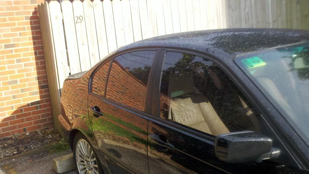

How does the trim looks? PICS
Sorry its not that close but it did come out good.
Originally Posted by Eddie328ci View Post
Can you show a DIY for window trim dip please !
Step 1: Tape the surrounding area, i did 3 widths of 1.5" tape and still had overspray. But its easy to clean up with a dry rag.
Step 2: Clean trim well to help it adhere.
Step 3: Paint a coat, wait, paint a coat, so on and so forth til its done. I only waited about 10 mins each coat and you can spray quite a bit on there with out any running.
Step 4: The worst part, remove the tape without taking the rubber with it. May try breaking the rubber between the tape and trim so it wont come off. I didnt and had to respray a few spots when it came off the trim.
Step 5: Enjoy and know it wont last forever, i still kinda liked the chrome on black look so i may go back one day if i get chrome rims.
