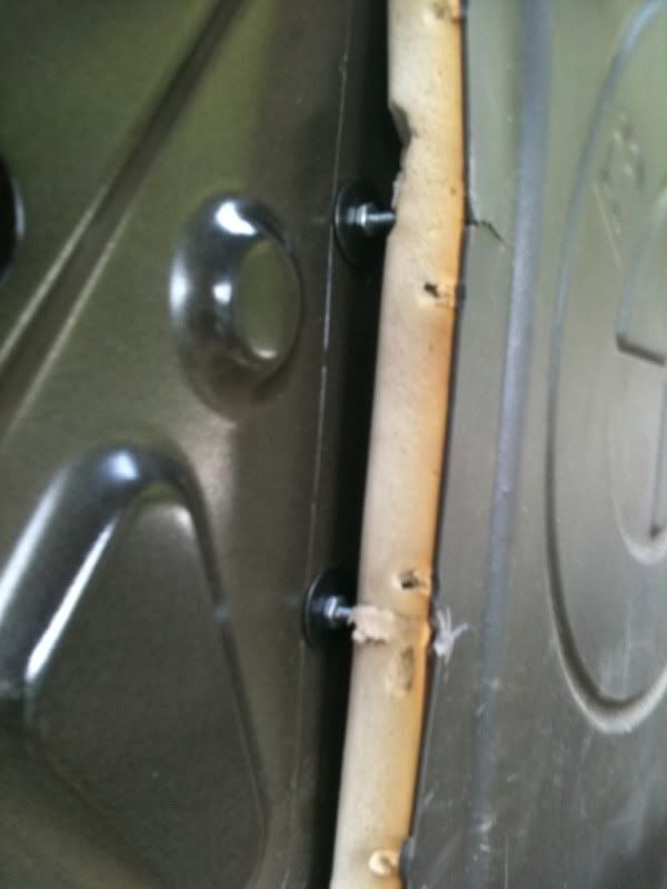

Drilled into the metal behind the seats to secure the piece of MDF:
View from the cabin:

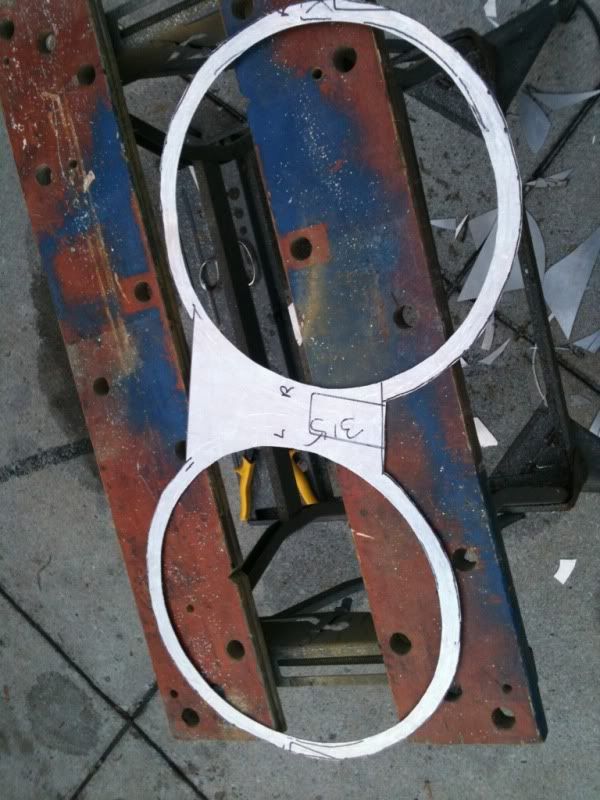

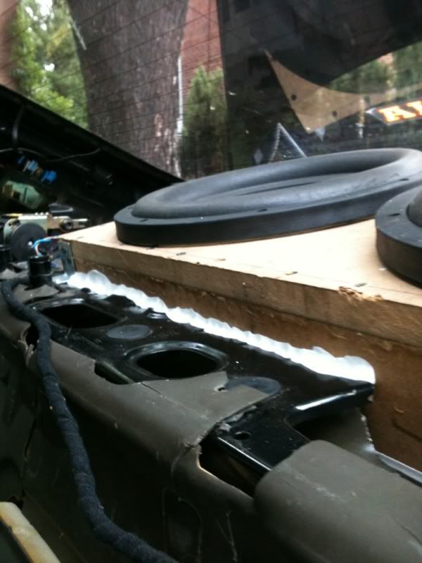

After about two weeks of brainstorming, I had thought up DOZENS of possible ways to do this. The most difficult part was the fact that the stock rear deck has a "trough" in it. In order to make it look neat, I thought i would have to basically delete this entirely. After test fitting the rear deck cover over the subs, the part of the box inbetween the subs, and really hte whole box itself caused the deck to push up ALOT in the middle. Now the middle of the two sub holes were cut out so as you can imagine, those middle parts stuck up because they were no longer connected. No pics of this. Then I decided in order to counter act this, I would construct a metal skeleton that would fit snugly around the subs, but would be fastened to the rear deck cover itself:
initial design + refinement:
Now on the subs with the deck: to give yyou an idea of what i was dealing with:
