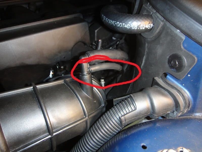

Well i've been putting everything back in, I decided to take off the purge valve to free up the bottom hose from bothering me. well I was putting the purge valve(also known as the fuel tank breather valve) back on, everything was fine, connected the plug, connected the small rubber tubing(this is where it all went bad), and as i was connecting the bottom tube that clamps on, i accidently pull the purge valve to much towards me and the rubber tube comes off something. It's attached to the purge valve but not the other end. I have no idea where it goes to and it seems like its really under the intake manifold.
What should I do. this is going to set me back about an hour or two if i have to remove the throttle body and the pressure regulator IF thats all i need to remove. PLEASE HELP ME OUT GUYS, WHAT ARE YOUR SUGGESTINGS.
I found this image, and it looks like i gotta remove the intake manifold, PLEASE DON"T TELL ME I GOTTE REMOVE THE INTAKE MAN. THAT WILL PISS ME OFF :ben: :censor::censor::censor::censor::censor::censor::censor::censor::censor::ben:

I haven't removed the manifold, but I'd suggest that first you use an inspection mirror and good led flashlight! If you can't see anything, you could remove underskirt and see if you see where it goes. From the picture above, I'd guess that if you have the small vac line only, that you could get it plugged into that rubber hose leaving the intake...assuming that picture is with that hose plugged in.
Let us know please. Also...you might search your issue by using a title search. 'breather hose' would probably work.

That part of the mani is so buried I doubt you can look that deep down with a mirror. You might be able to pull that 16mm bolt wayyyy down at the bottom of the manifold and then pull all the 11mm manifold to head nuts off and lift the whole manifold up just enough to get your hands down under there and re-plug it in. Not sure though. Good luck man

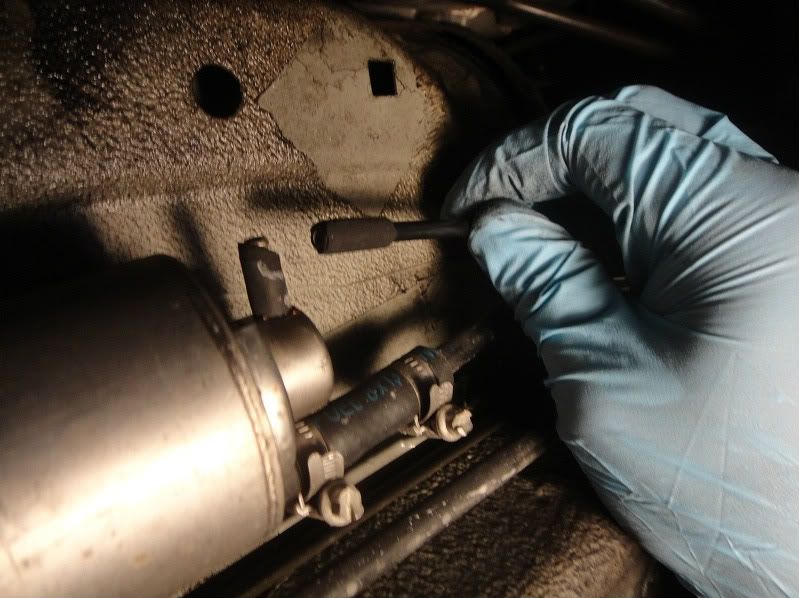

Alright guys, so I'm pretty sure i figured out why im getting the EML lights or at least why im getting the p1084 and p1086 engine codes. As I got under the car to change the fuel filter, I noticed one of the tubes was broken off and disconnected. I think its the tube that connects to the upper intake boot. The tube that you told me to blow through dslboomer. Now does anybody know the part number for the tube??? it's not just a regular rubber tube, this one has a metal lining inside.
Alright now I also noticed an empty spot here. Is this normal ?? or is their supposed to be another tube here?????

...As I got under the car to change the fuel filter, I noticed one of the tubes was broken off and disconnected. I think its the tube that connects to the upper intake boot....
... now I also noticed an empty spot here. Is this normal ?? or is their supposed to be another tube here?????
Excellent!:clap:
Glad to see that you followed through and put efforts to take pictures to share with us.
Hard to match the part number in the realoem.com. Illustrator got lazy on many parts I found. It doesn't have a metal liner. It is 90 degree elbow vacuum hose that was broken off from the vacuum port of fuel pressure regulator. Just take the fuel filter with you to Autozone to get a 90 deg elbow with matching diameter.
You are not missing anything in the clip. It is empty spot there.
