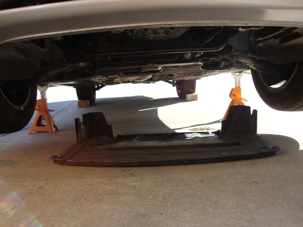

Step One: Lift the front of the vehicle
Step Two: Remove the front underbody panel. Just a few phillips 180 degree turn screws.

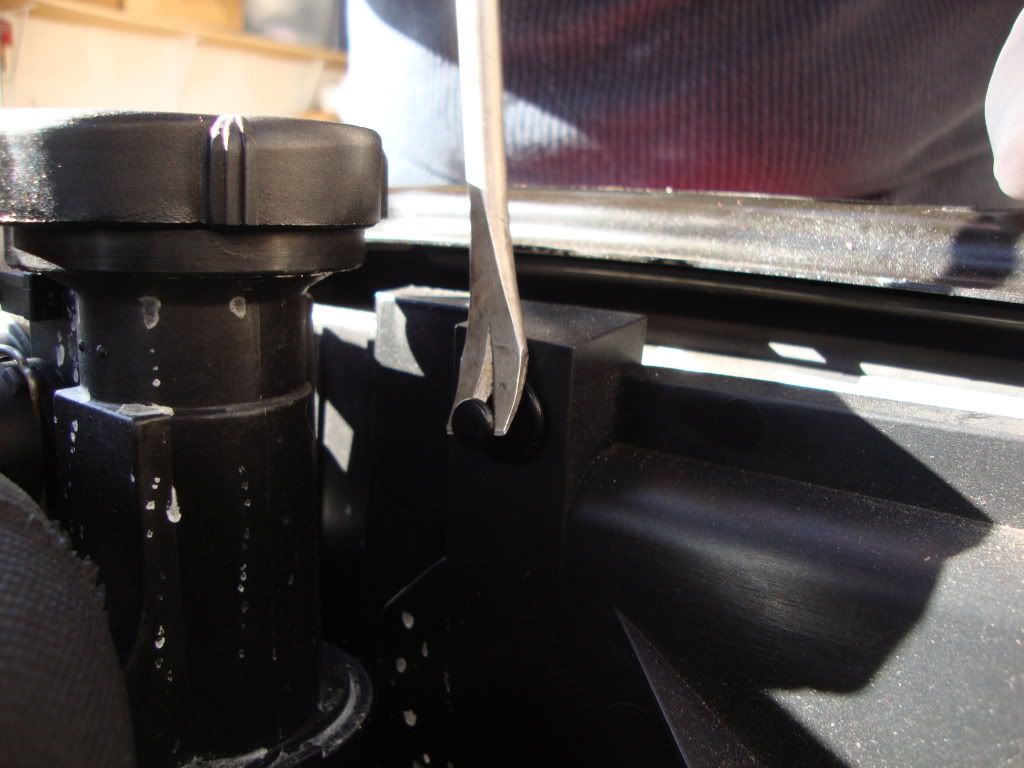

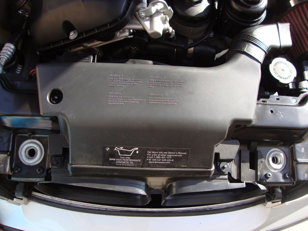

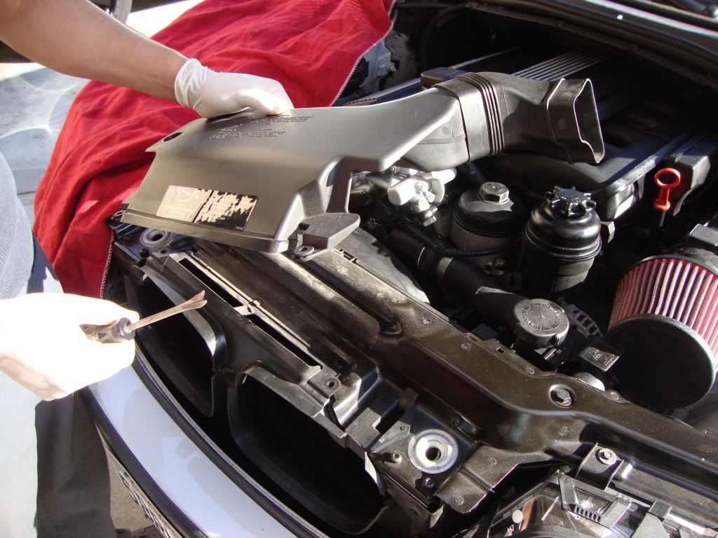

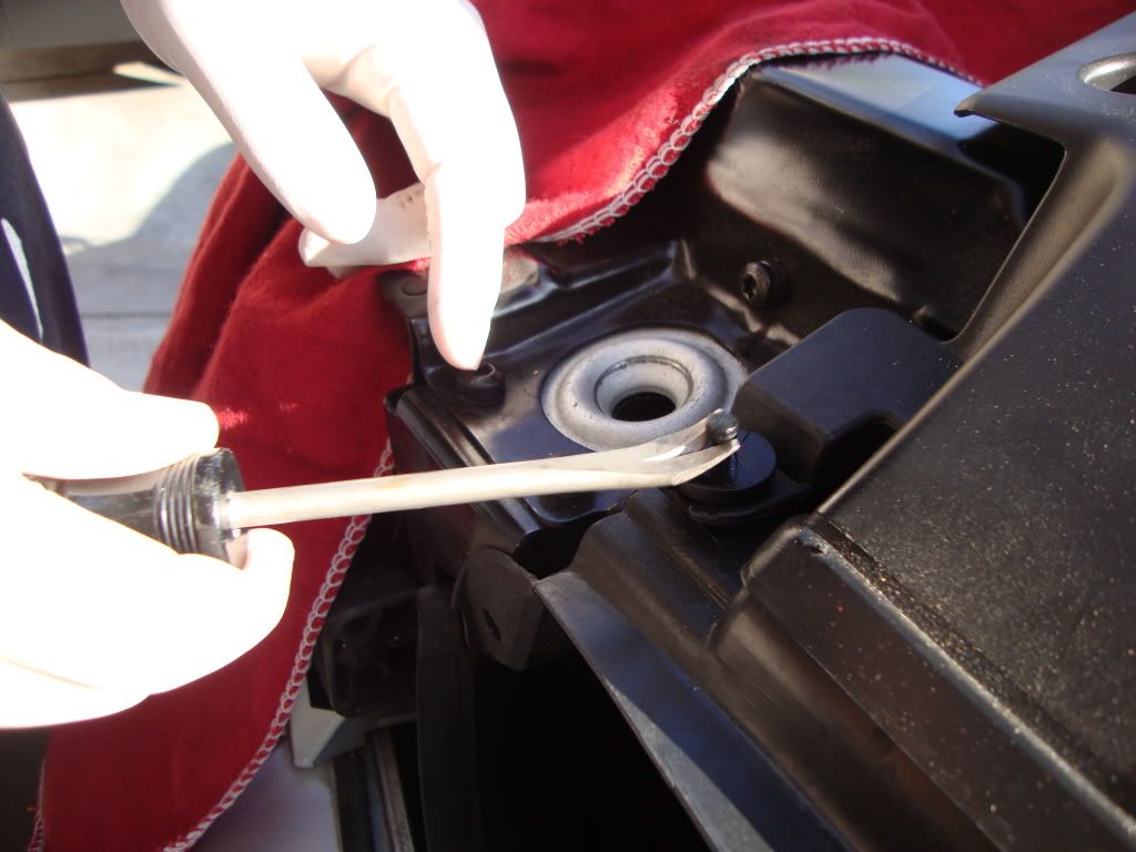

Step Three: Remove air duct for air box. It is held down by 3 plastic rivets. Pry them up gently with a tack puller. This is a very handle tool for working on these cars and I highly recommend getting one if you like getting your hands dirty. $6.99 at Sears.

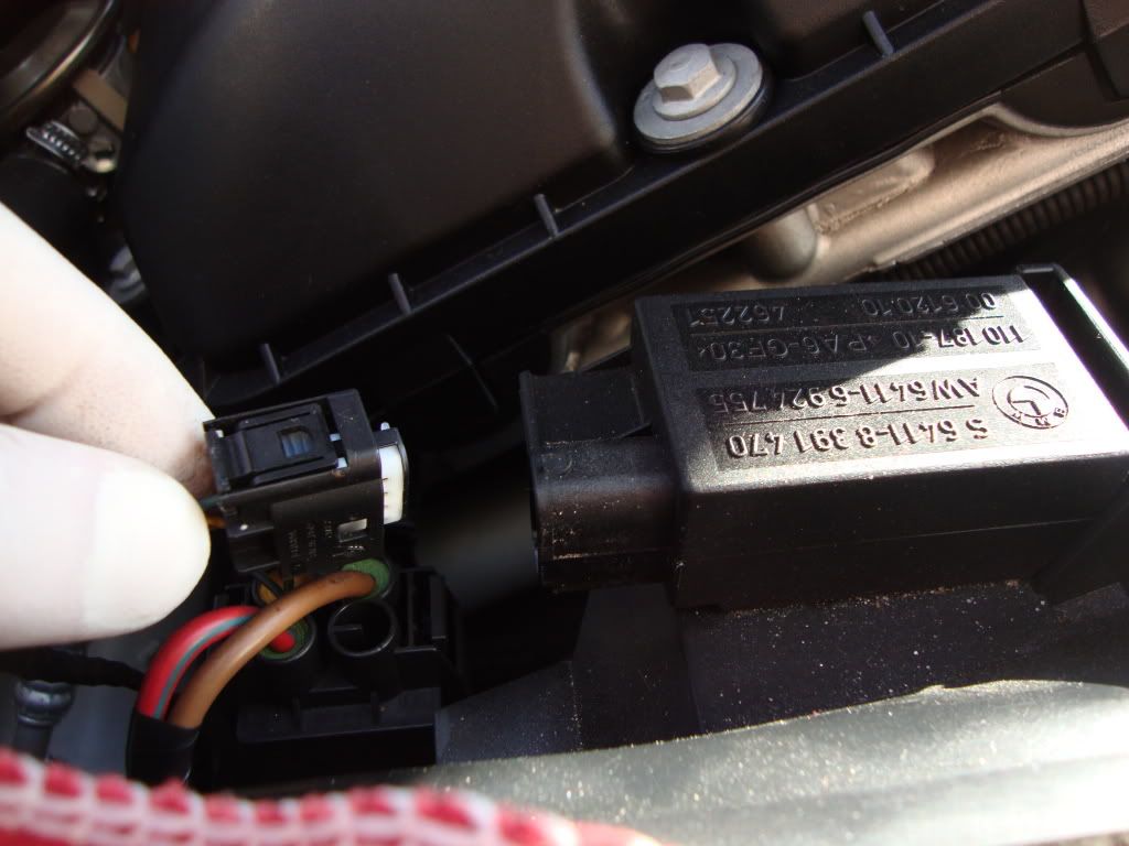

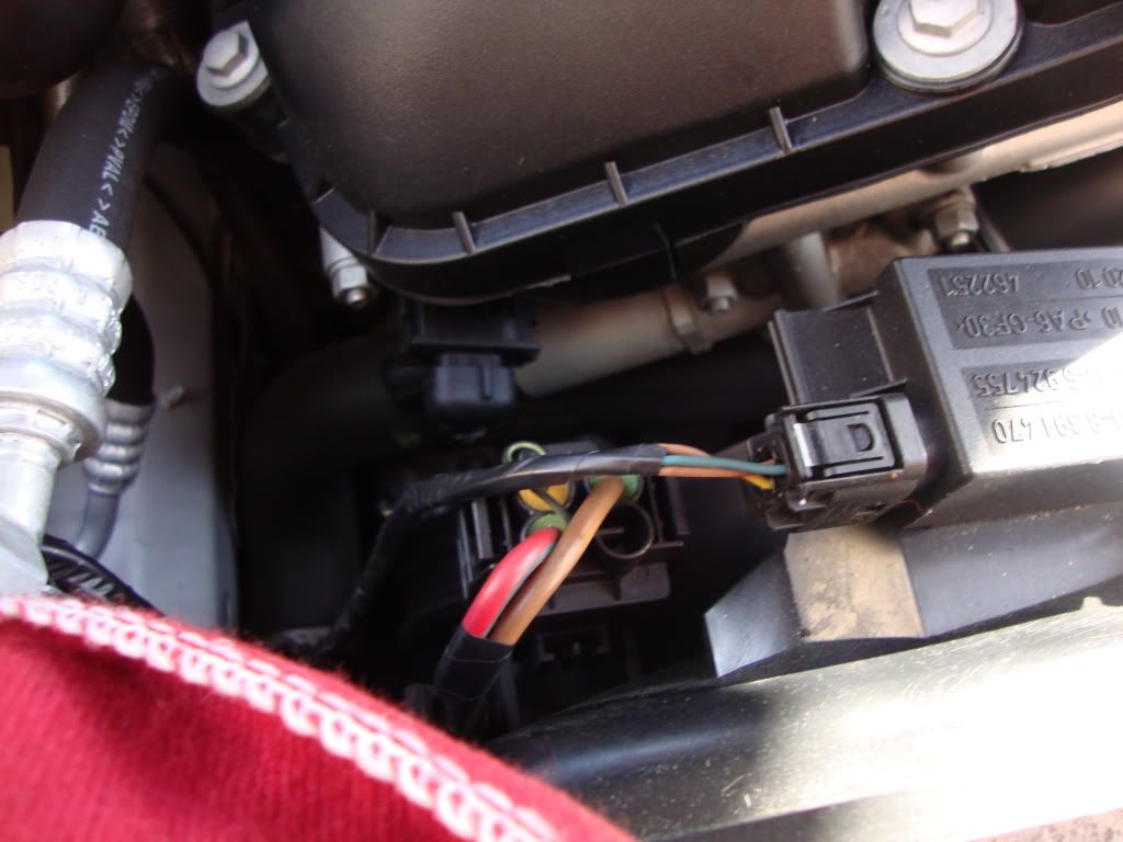

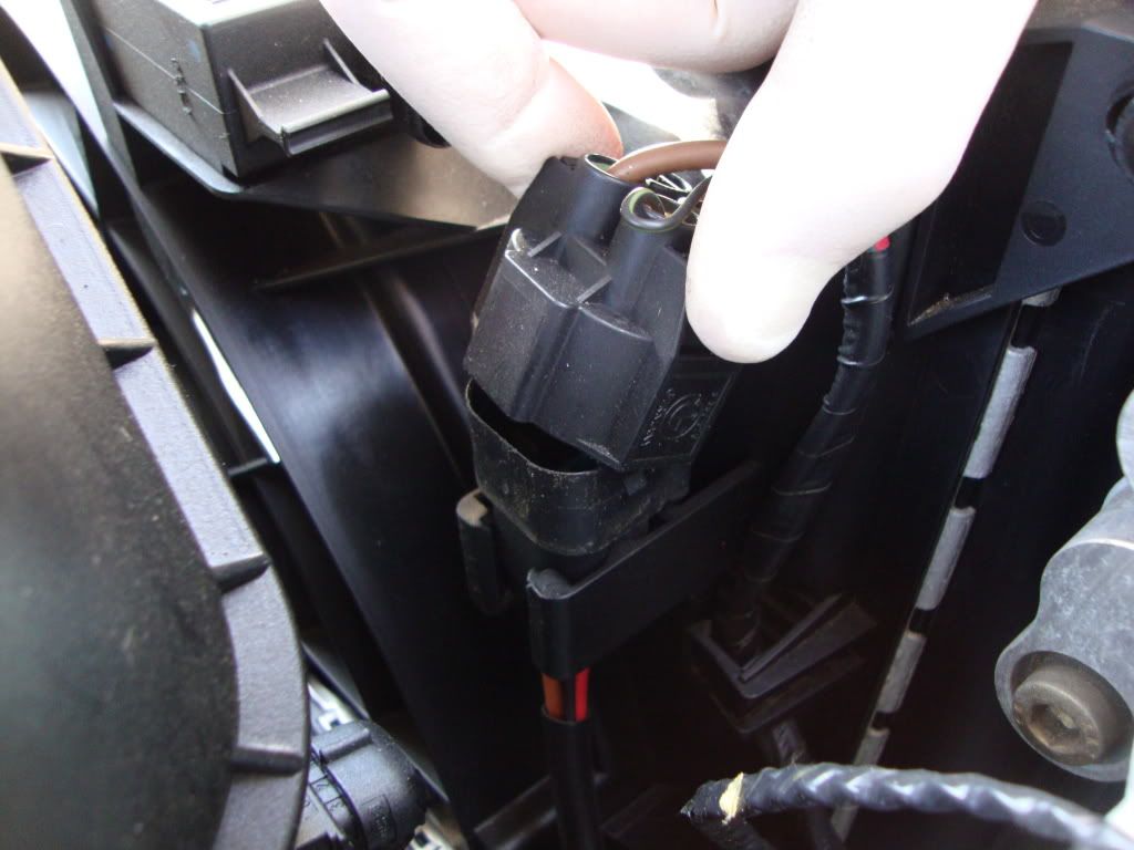

Step Four: Disconnect the "Smelly Cow Sensor" and Fan Connecter which are located on the passanger side/top of the fan shroud. Unwind the wires from the various hooks that hold them all tidy and out of the way. Then move them out to the passanger side of the car so they are out of your way.
NOTE: The "Smelly Cow Sensor" is the sensor that detects impurities in the air, such as a dairy farm or big diesel truck. When your climate control is set to Auto Recirculation it will automatically shut the vents from outside so that these smells do not make it into the cabin.

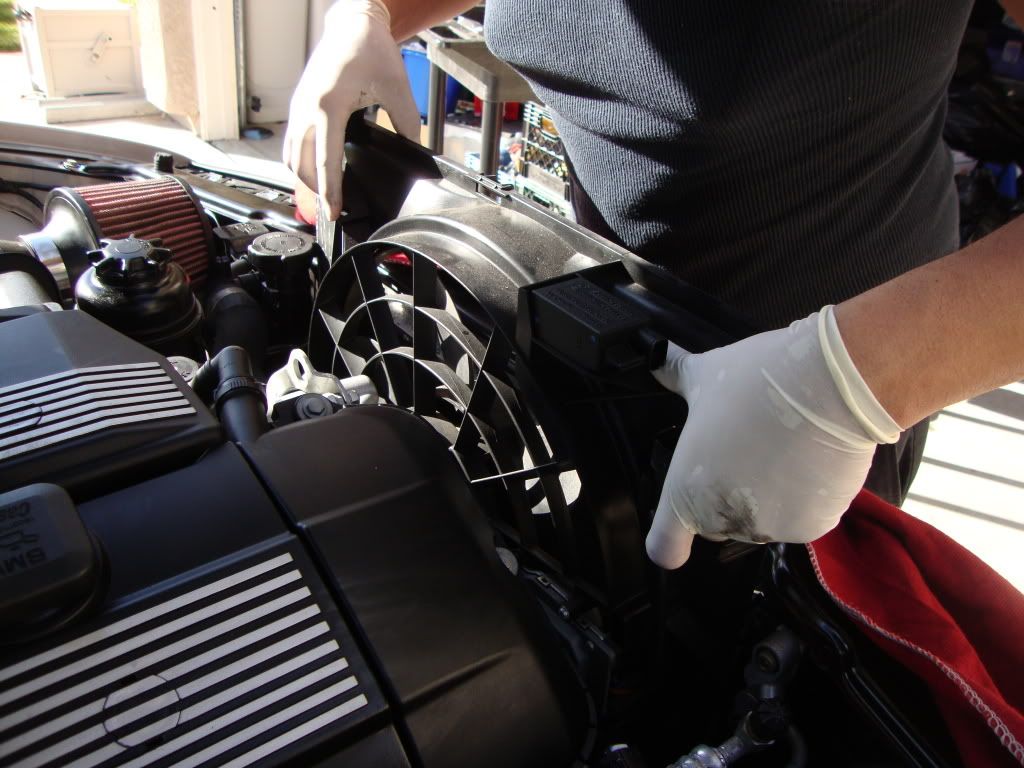

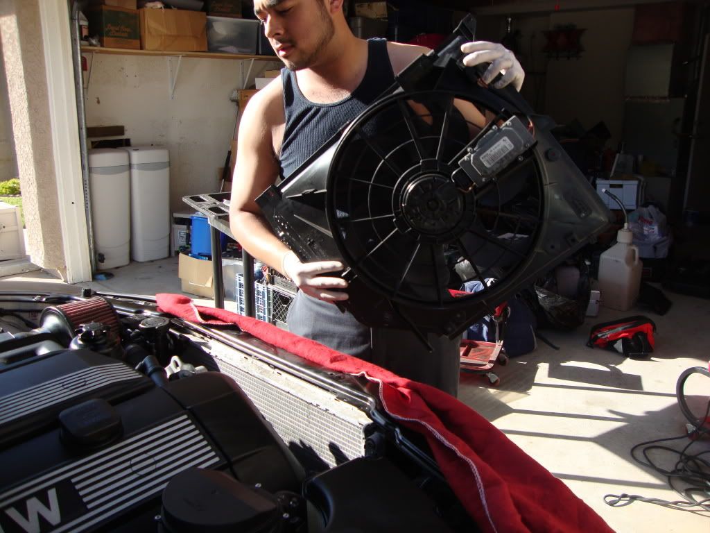

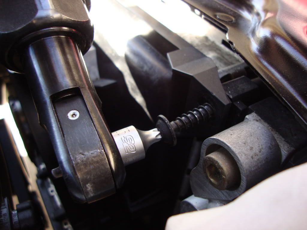

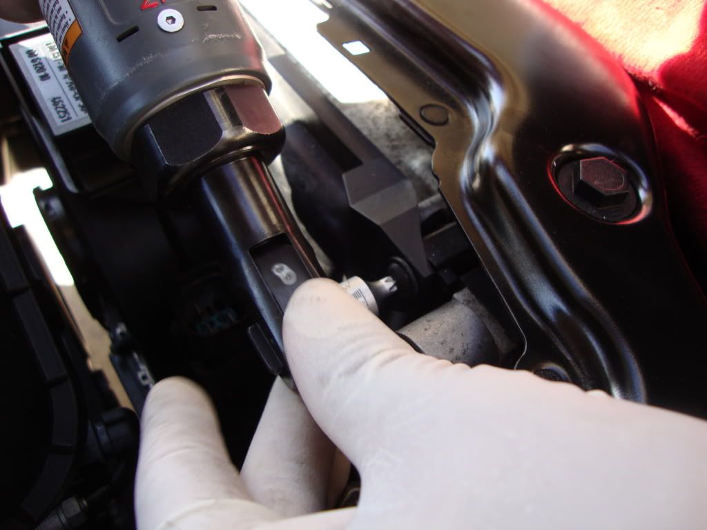

Step Five: Remove the Engine Fan/Shroud. One plastic rivet on the driver side of the shroud and one T25 torx screw on the other.
NOTE: The process for changing a thermostat is slightly different on an automatic transmission vehicle rather than a manual. Automatic transmission vehicles have a engine driven fan that mounts to the water pump. A 32mm wrench is needed to remove this, It is REVERSE threaded. The fan most be threaded off of the waterpump first, then the fan shroud and fan can be removed together.
Since my car is a manual transmission it has an electric fan. This makes it much quicker to remove.
My buddy Greg who is an Infiniti Tech came over to hang out... So I put him to work.

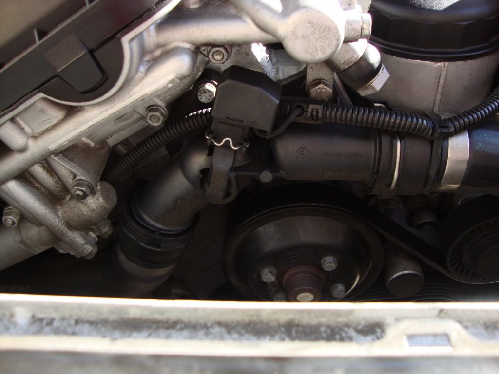

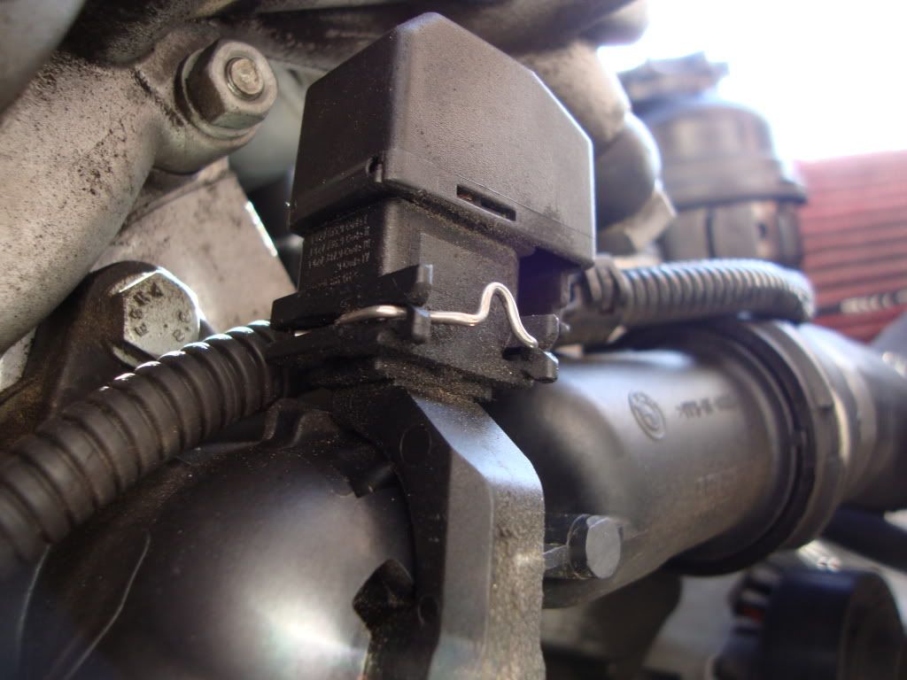

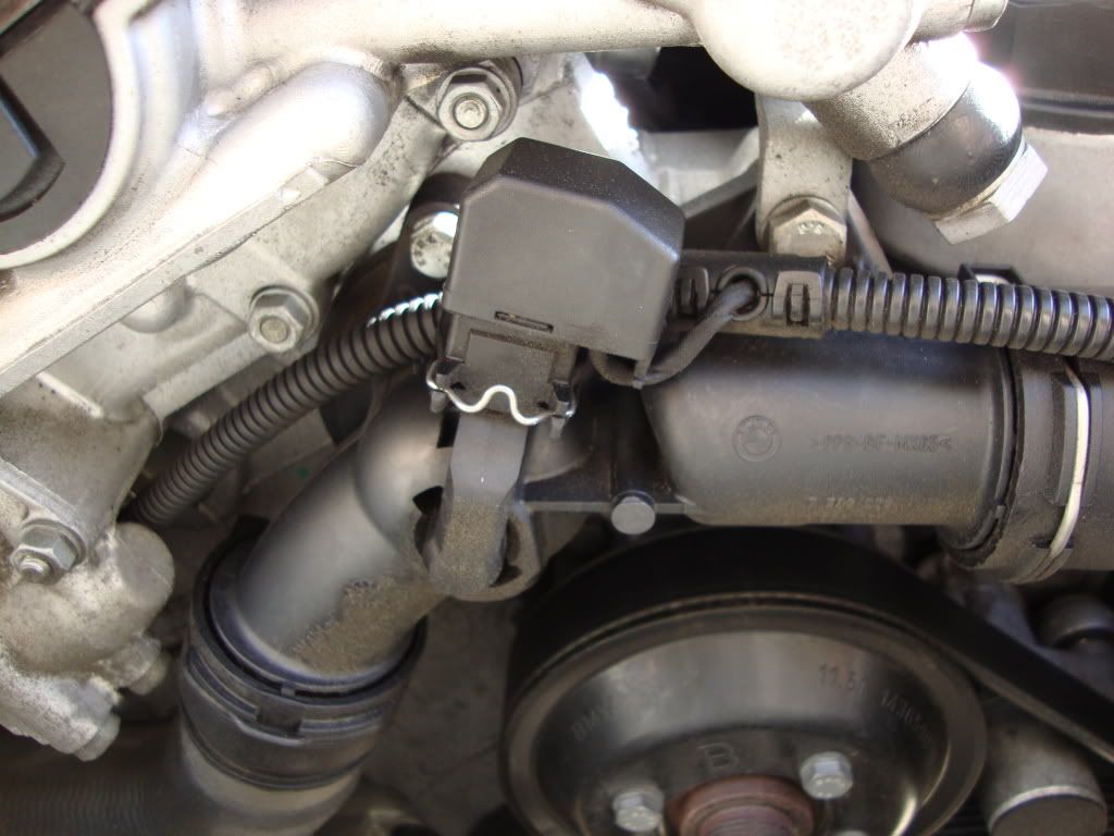

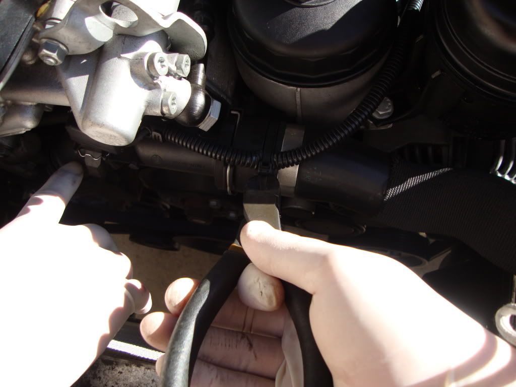

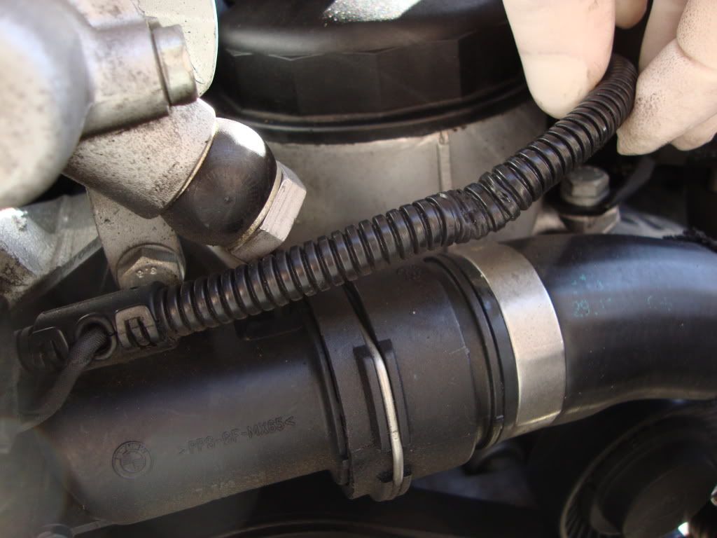

Step Six: Now we can really access the Thermostat. Cut the zip tie holding the wire haness to the upper radiator hose and disconnect the electrical connector on the thermostat housing.
