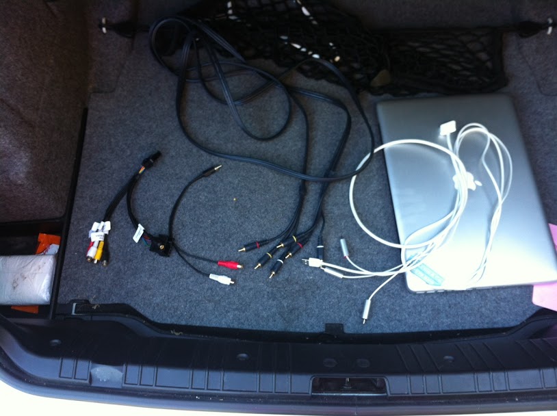

You will need:
-Oem head unit
-TV Tuner
-Ebay AV input for bmw pre idrive
-Av connections for your device (i found all mine lying around the house)

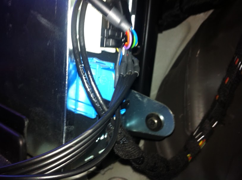

Firstly, remove all your boot carpet on the nav/tv tuner side.

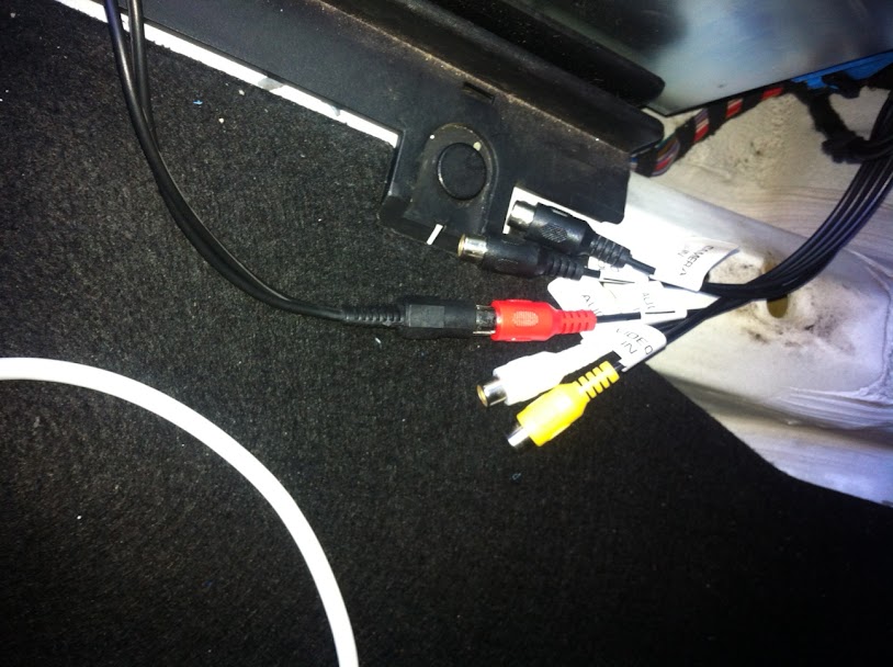

Plug in Av connection to the White female socket on the tv tuner (dont spend 1 hour working out why the blue cable doesnt want to fit in the av input cables)
Connect the av inputs to the cable,

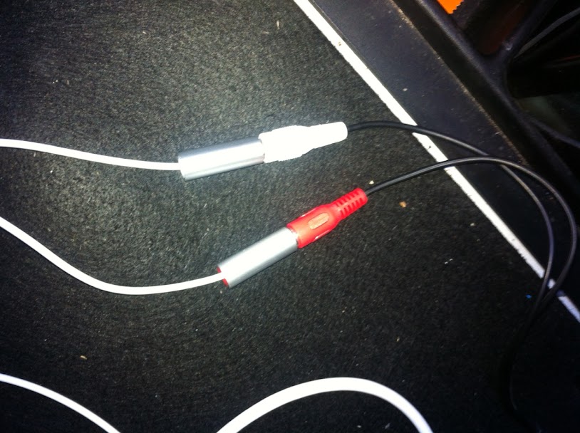

in this case i connected a stereo to mono y adapter so two stereo feeds are combined to the single mono input on the av

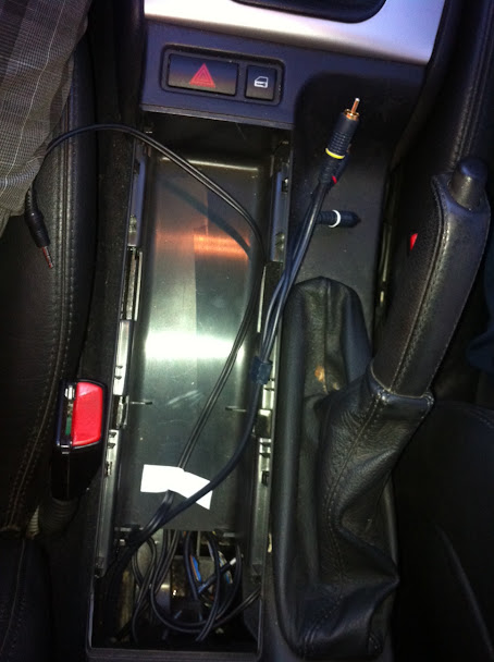

run your cables to the desired spot you wish to have your connections
select av on your head unit tv tuner and presto, you have audio and video on your screen
