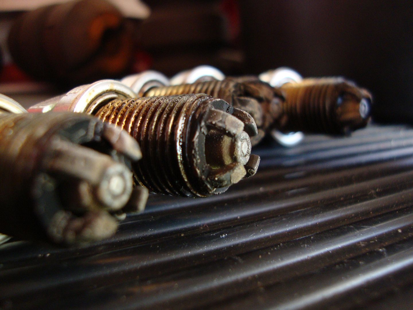

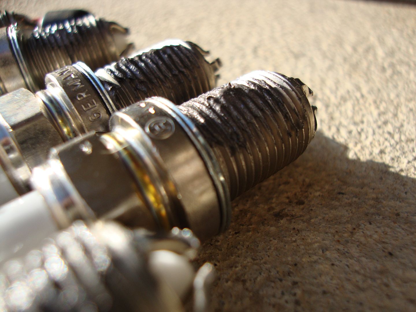

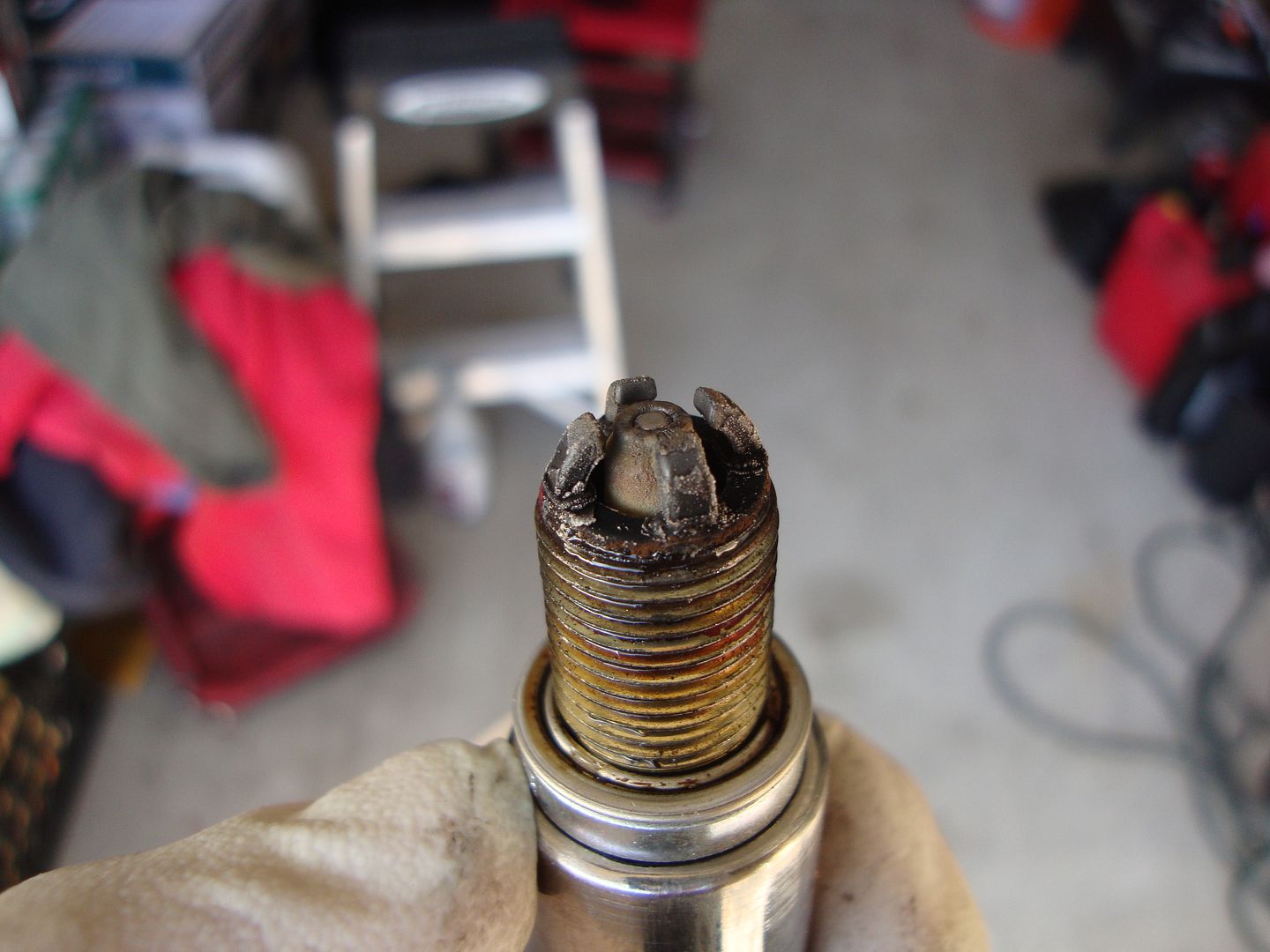

I noticed immediatly after installing them that my fuel economy has improved, under same driving conditions. Its no surprise considering the way my old plugs looked!
I had a intermittent thermostat fault which would cause my car to run a little cooler, which in turn made it run a little richer, hence the darker plugs.

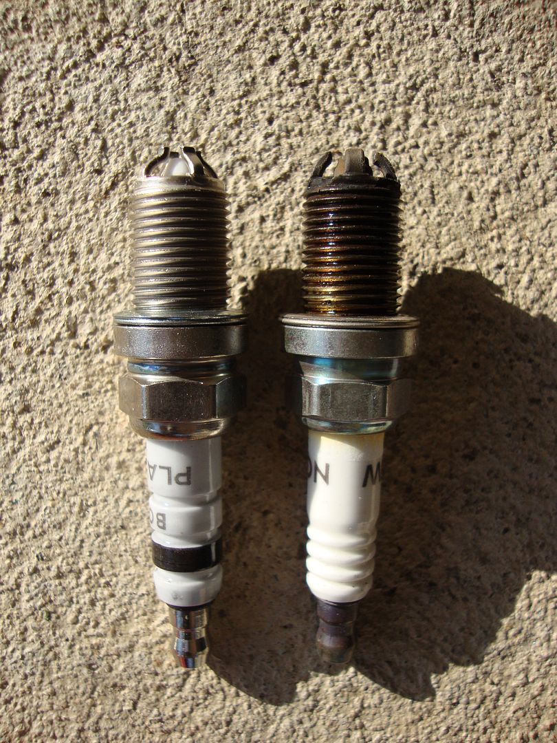

My old Spark Plugs after 82k!!
A comparison between the Bosch and the NGK Plugs, Very Similiar.
