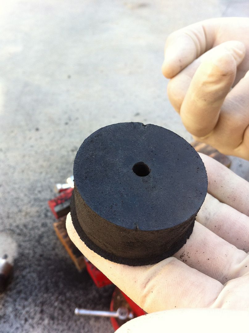

Went to the local sport store and bought 6 hockey pucks.. 2 bucks a piece = fantastic bumpstops.
They are very hard compound rubber and work great! I used a whole drill bit to cut out the center of the hockey puck, about a little over an inch diamter, then drilled a whole in the center. Used a razor blade to cut a slit down the radius of the bump stop.
They are very hard and dont deform under the cars weight at all.

A good way to find the righ amount is simply start out with a random amount on the concervative side like, 3 or 2.5 hockey puck bump-stops. THen back one rear wheel up a curn so it fully compresses and the other stays on the street. See how far the suspension compresses before it is sitting on the bump stops. If your fender runs into your wheel, then you need more bump stops. If it stops when they are far away from eachother, than you have to much! Take some out.
Dial it in and get the perfect amount so your wheel stops a few millimeters away from the fenders.

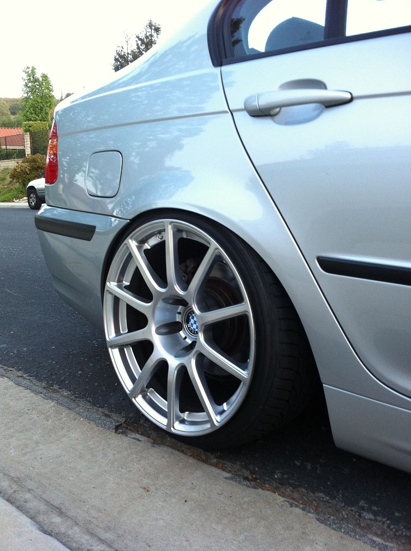

I lowered the back about 1/2 an inch since I got the fenders pulled.
I will take pics with a better camera in a few days.\
Front:18x10 et12 Rear: 18x10 et20
