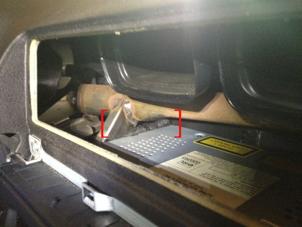

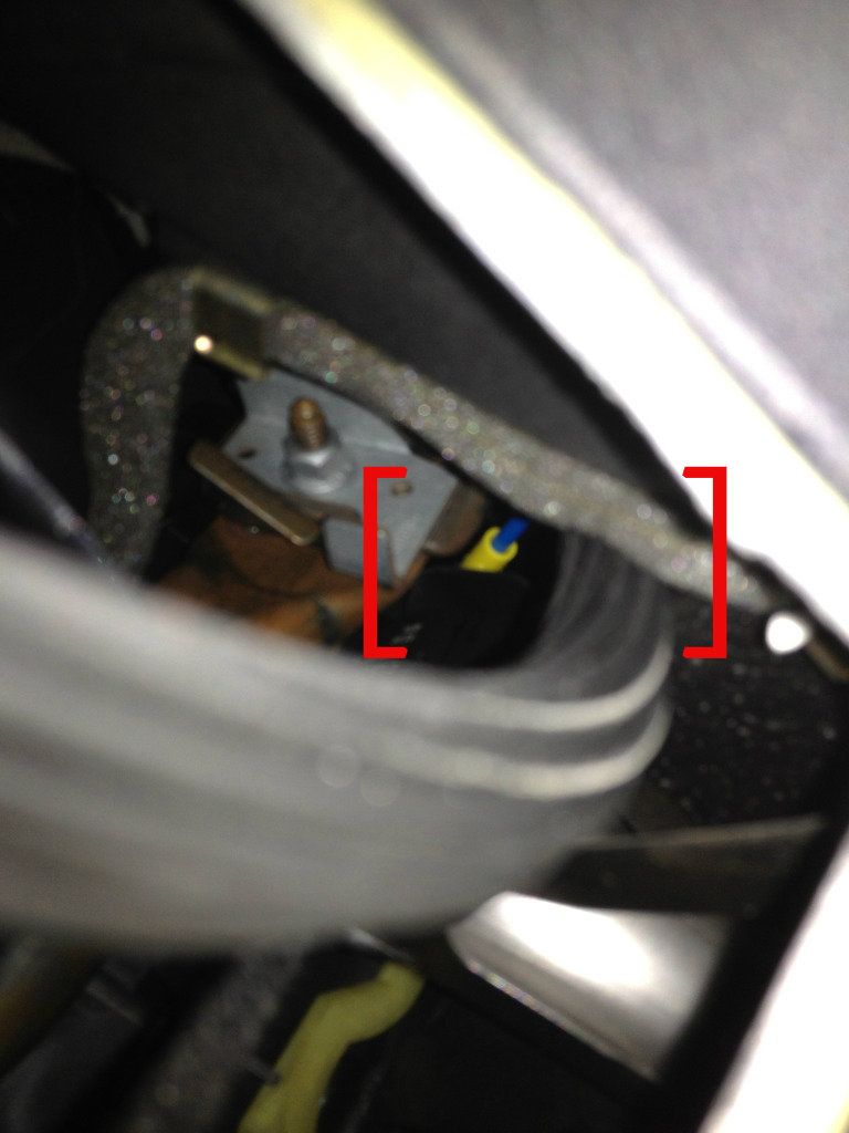

Step 7: Run the NAV side connector up through the slot on the top left side of the glove box. I just pushed it up and I could easily see and grab it with my hands, needle nose pliers might help if you're doesn't feed up so easily.
Look there when feeding it up, the blue and yellow piece, it will come up to the right of it.

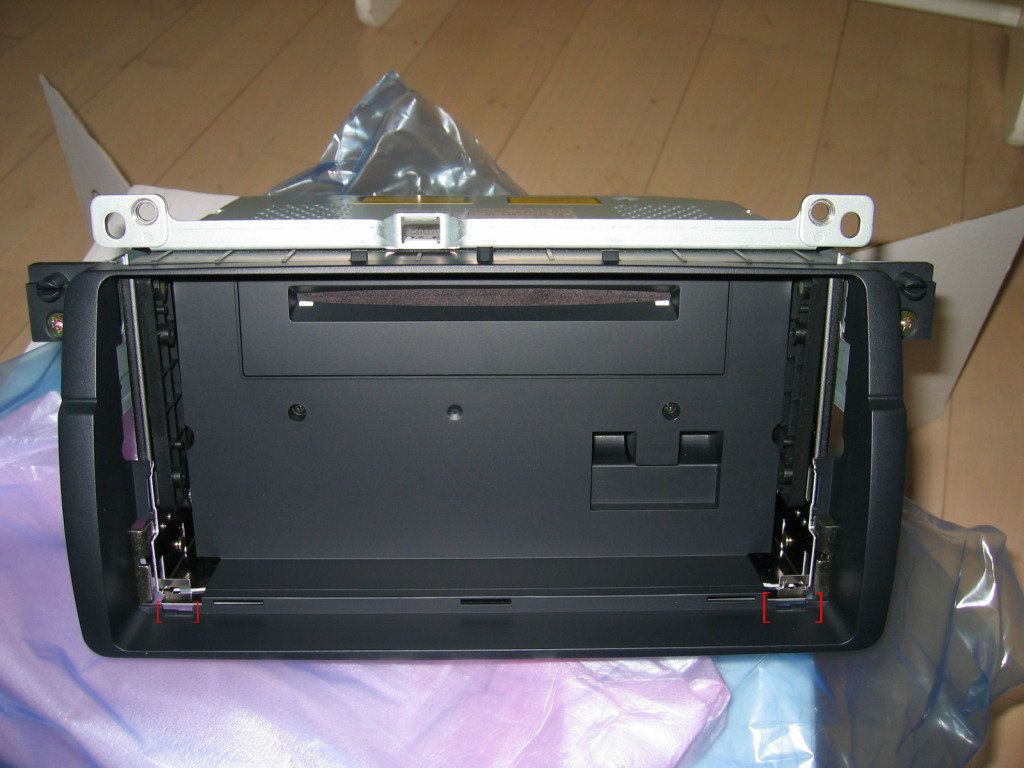

Also, you stick the nail files in these two places. I can't add anymore pictures to the original post.
