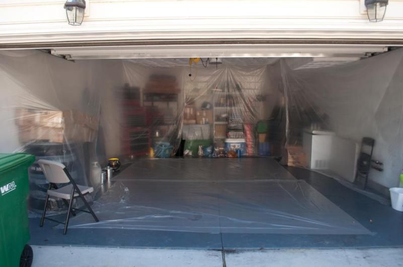

Setup
My garage "fits" 2 cars so I had plenty of space to move around in it and set up the sheets to mask just about everything. The only pointers I can give would be to cover EVERYTHING. My roommate and I were under the assumption that as long as we mitigated over-spray, then we'd be ok for the most part, well yes and no. Yes in the sense that we never got any on the walls and floor. No in the sense that its still an airborne paint that's coming out of the gun so when i finished and turned to the sheets, i saw a beautiful pattern all along it.....and the ceiling. Its really nothing major and you can hardly tell (and its comes off pretty easily) but yeah DEF should cover what you dont want to have excess paint on.
