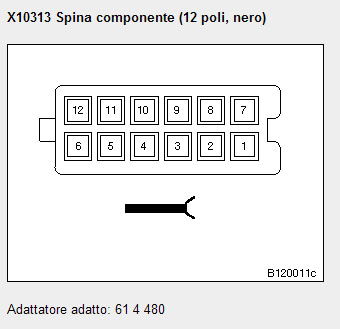

You will have to get the mirror folding module (this) and wire it up. Cars without memory seats are *not* prewired for powerfolding mirrors.
Yes that is what I need, but I still have not figured all the pinouts.
So far I figured the below fro my own research:
Pin 1 - Driver Mirror (white wire)
Pin 2 - Driver Mirror (yellow wire)
Pin 3 - Fuse Box, position 57 for 12V
Pin 4 - ?
Pin 5 - Ground
Pin 6 - ?
Pin 7 - Passenger Mirror (white wire)
Pin 8 - Passenger Mirror (yellow wire)
Pin 9 - ?
Pin 10 - ?
Pin 11 - Speed Sensor (Pin 21 of ABS Unit)
Pin 12 - To Pin 6 on driver mirror switch
And I'm wondering if the other pins can connect to my remote key when locking/unlocking and the reverse tilt function. As can seen below the mirror module does have available pins to pinouts 4, 6, 9 and 10.
