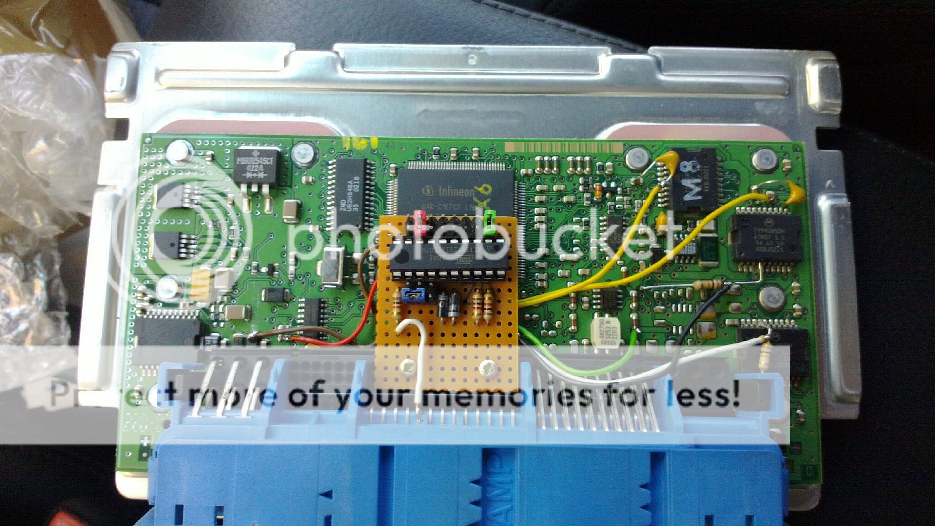

Here is how the EGS unit looks like opened up

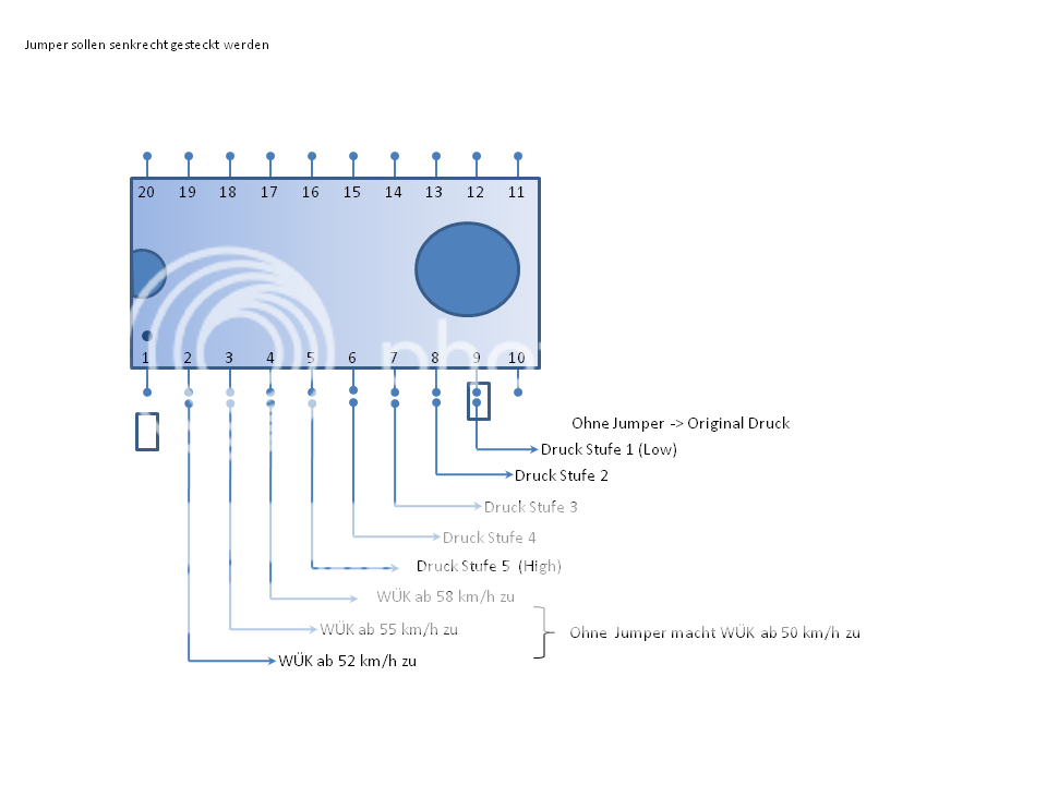

Here is the settings that can be adj on the unit
When going up in pressure on the TQ it is only for 4th and 5th gear(mostly). You do feel it shift alittle crisper 2-3 but not that noticeable.
