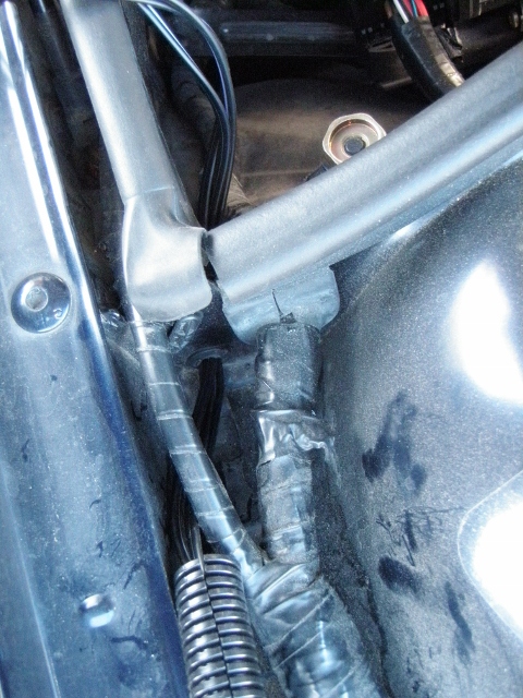

Location of Components: GPS Aerial back deck in the stock GPS aerial location. I used to have my XM aerial here, but I got rid of XM. The wiring for this ran down the doorsill harness on the passenger side.
