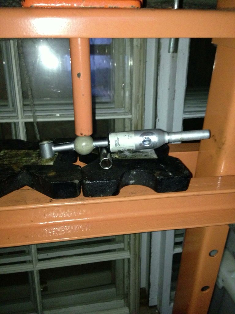

A little fyi, converting a 5 speed to a 6 speed clutch alignment tool:

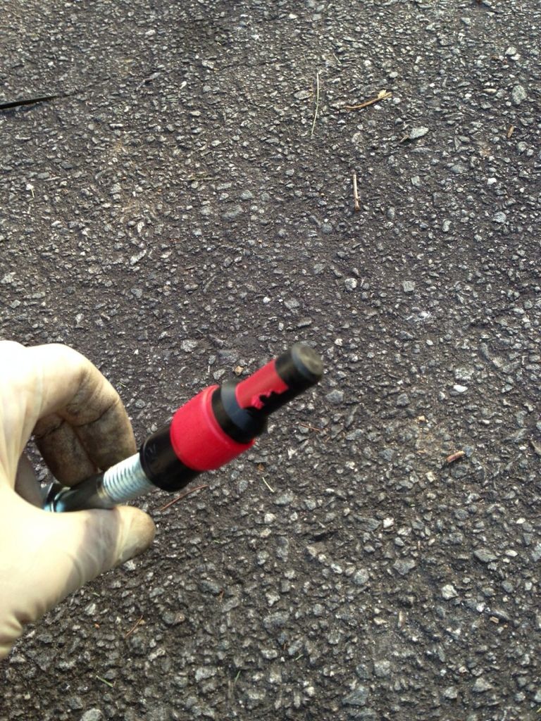

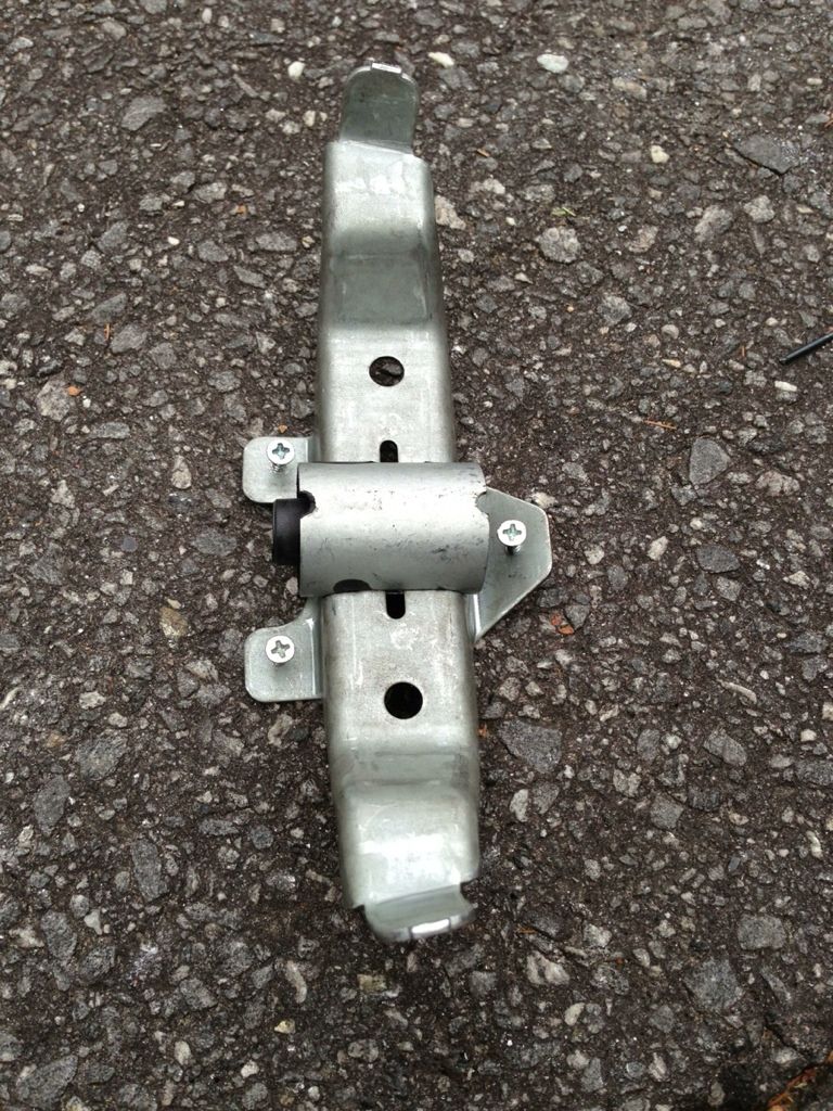

Went to the dealer today to pick up my t/c bolts and to my surprise my bracket was there!!
and then it ended up on my forehead during installation :-/
(reminded me why I always wore a hat during car work)
Not the finest install job, but it was in there nice and tight... and that's what counts

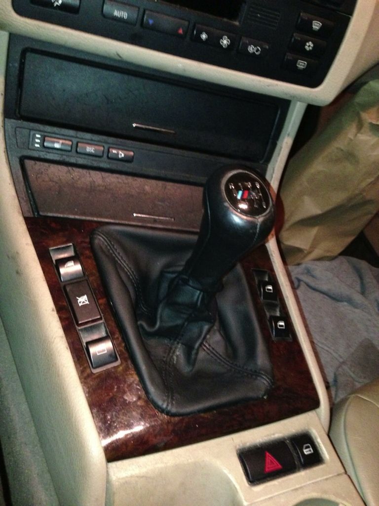

At this point I could start messing with my z4 3.0 shifter. The shifter sat way too far forward, to the right and hit the transfer case, so I bent the linkage arm about as much as I felt comfortable:
Then I modified the shifter to straighten out the location of "neutral"
Overall I was VERY happy with how it came out (it's sitting in 3rd, ie a hair bit too far back by OE BMW standards, but i'm ok with that, feels natural to me):
That said one I reinstalled the transfer case things got very very tight between the bottom of the shifter and the transfer case, not sure if this will transmit NVH while driving.. I guess we'll see.
