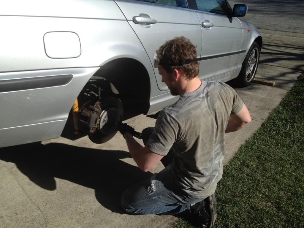

-Worked some more on Derek's M3 LSD swap. Got the brakes off and removed the e-brake cables since we'll be reusing his 330 ones which are in better shape.
Oh and Nathan (wh33lhop) has been over quite a bit trying to get his Metric Mechanic LSD and rear wheel bearings sorted so we've spent some time under his car, too. Haha.
Dru (DrusC5s) also dropped by:
Pics courtesy of Kyle (323ci newbie)!
