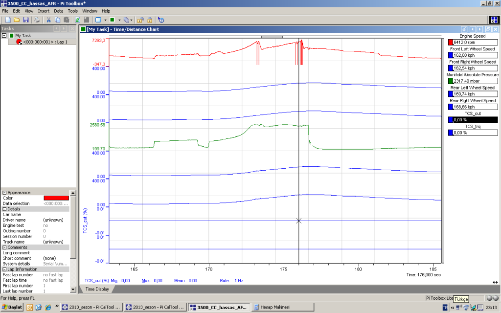

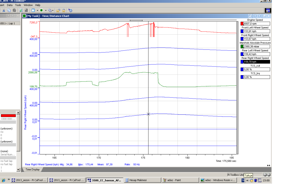

AWD mode ON: front wheel speed 153 km/h = 95 mph
AWD mode ON: rear wheel speed 159 km/h = 99 mph
4 mph difference.
In RWD mode difference was up to 25 mph.
traction control does not kick in despite 225 tires. Even in 2nd gear we cant trigger traction control.
TCS_cut = traction control is zero all the time.
Time to work on the wheel arches to put 315 rear tires.
