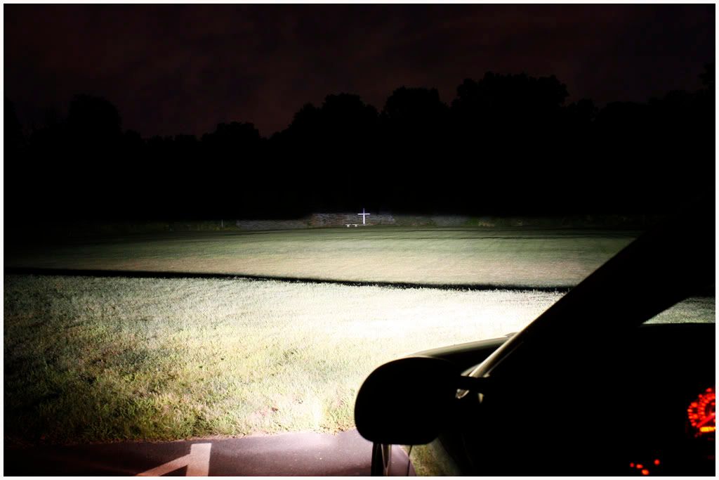

That output may or may not be acceptable. It's tough to tell with it shining on a wall in the garage a few feet away. As a comparison, here's my TSX retrofit shining a good few hundred feet out (I don't know of any PNP kit that retains this level of uniformity)...

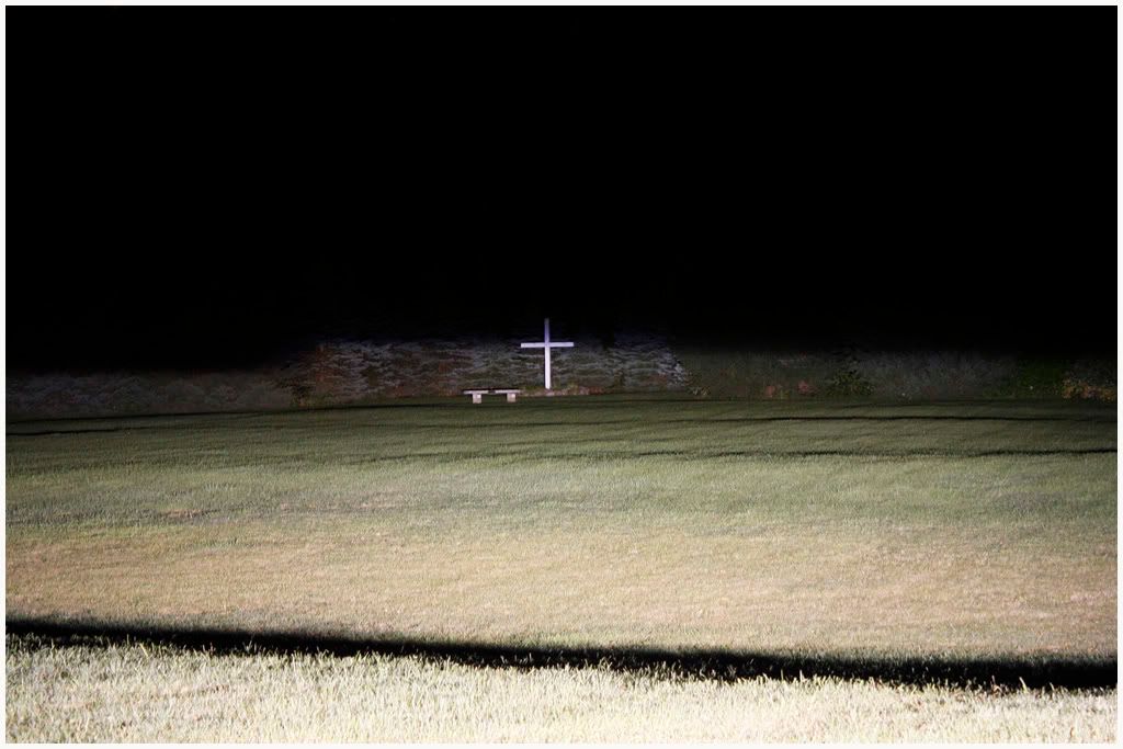

And zoomed in...
