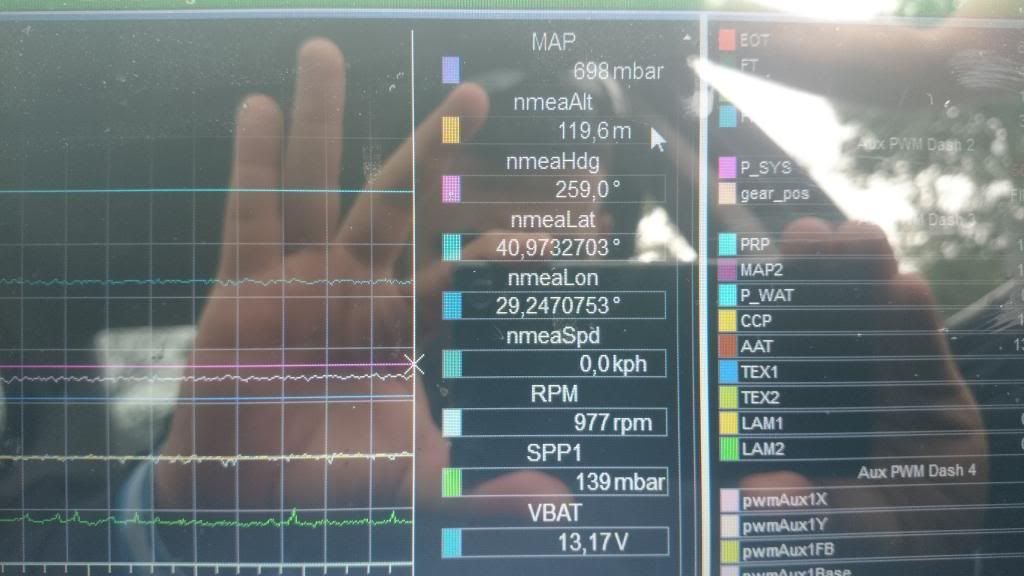

Road tests started.
Cosworth GPS Works, altitude, longitude, latidue, speed are logged by Pectel
These logs will be beneficial in analysis..

Mapped up to 5500 rpm 15 psi, using teamviewer, and terminated mapping testing due to tires' imbalance. With the broken leg I can only map by using teamviewer.
