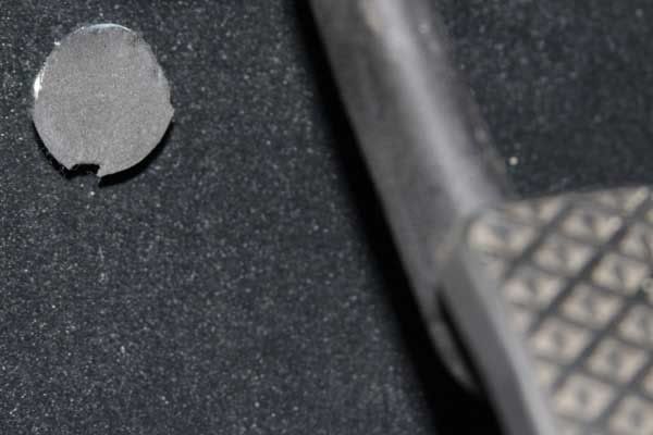

MOD NAME: Clutch Stop Mod aka Perfect Clutch Stop
MOD COST: <$5.00
MOD BENEFIT: Less Clutch Travel, Faster, Shifting (Manual Transmission Only).
MOD DESCRIPTION: Screw in a 1.5" elevator bolt with a adhesive furniture leg pad in place of stock clutch stop.
Clutchstop installed:
MOD LINK
http://forum.e46fanatics.com/showthread.php?t=206363
