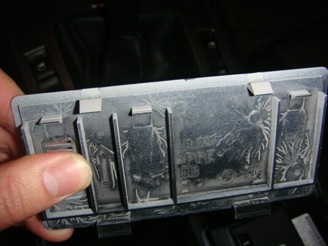

Start by using a flat head screwdriver and gentle pry open the cover. the 2 tabs will pop out and you will be able to slide the cover out.
Step 2:
You can see the underside of the cover, the 2 tabs at the top that lock. Note: 2 "L-shaped" sliders at the bottom, those help hold the cover.

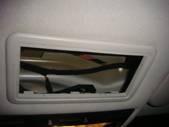

Pop the outer trim off by using the flat head screwdriver to lift one of the edges and pull.
The cover removed, exposing the trim and metal backing plate.

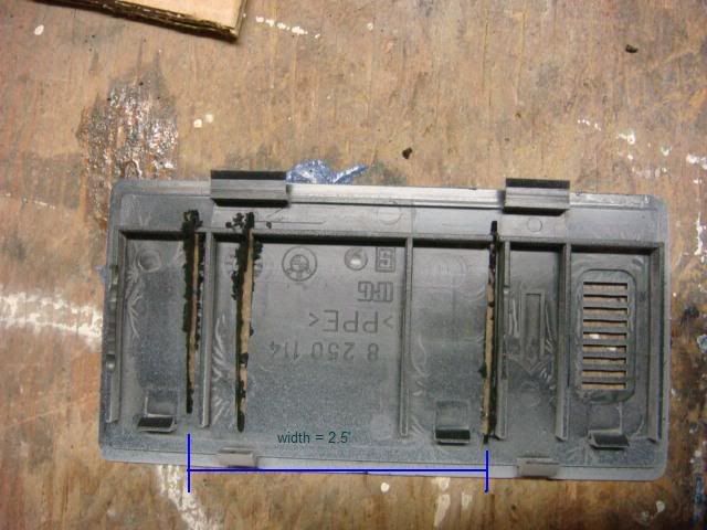

Measure out spacing. I found if you score a line with a razor, its makes it easier to cut out. Dimensions are 2.5" by 2.0" Use the part number, BMW symbol and microphone slits to help you with the orientation of the cover. Please note I took the photo after I cut to show the dimension lines.
Step 5:
Secure the cover to the table (or any another stable object)
Notice I have scored the line I want to cut. I found it easier to measure out the piece and making the lines BEFORE CUTTING. That way you were able to see your general cut out shape. Should be 2.5 x 2.0 rectangle.
Step 6:
Here is were you will need the Dremel. Take the cover and cut along the razor lines. I also suggest you leave yourself a little room so you can file/sand down the extra towards the end. It doesn't matter which side you cut first. Safety Eyewear is a good thing to have here, Dremel bits may break, or plastic pieces may kick up. You can see how I cut the 4 sides
