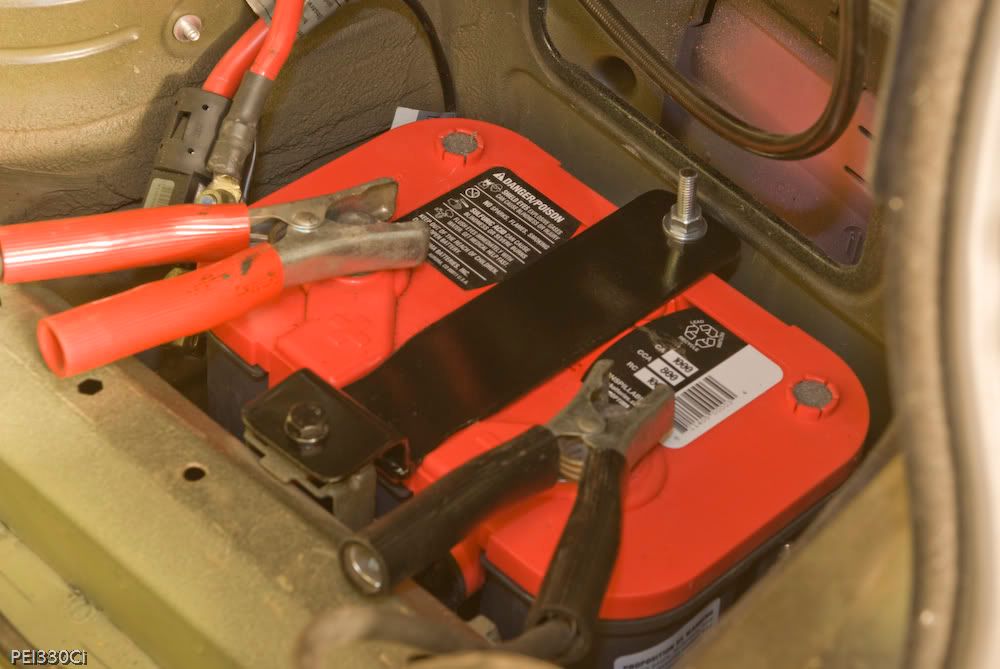

New battery hold down bracket:

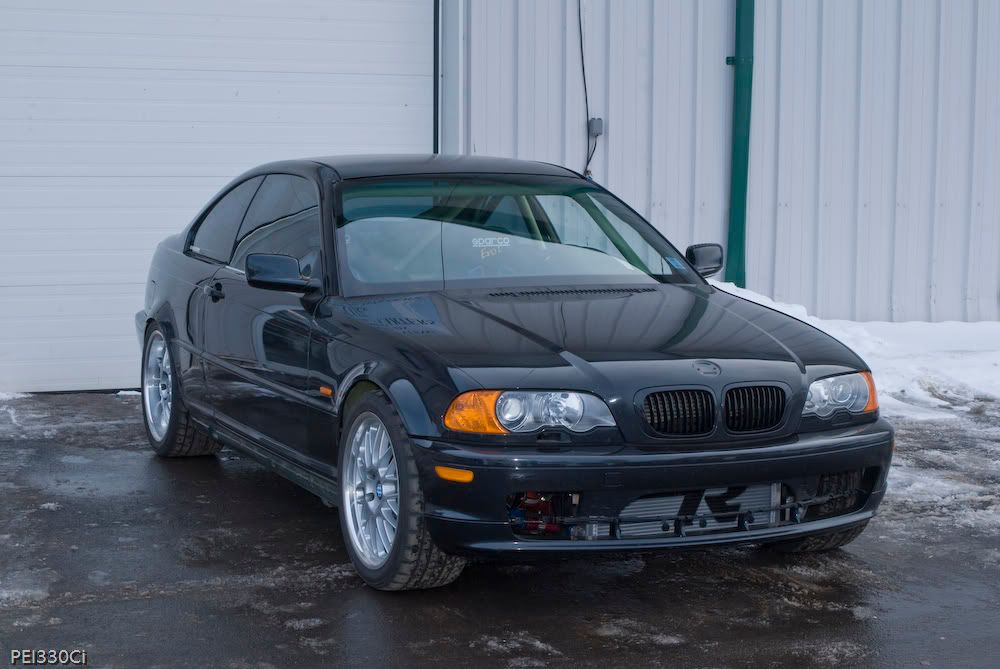

The car ready for loading on Thursday evening:
I took the car home with me on the trailer Thursday night, then left early Friday morning for BMW Moncton. (In New Brunswick) Just after 9am they had the car connected to their diagnostic/programming system with the car checked out and ready for starting by about 10am.
