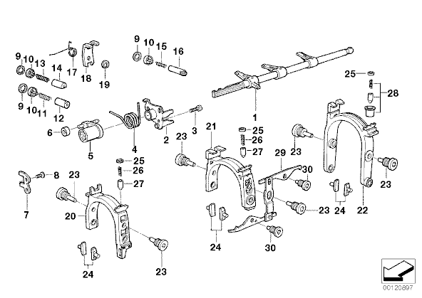

A lot of people experience what is called a "sticky 5th gear." If you decide to do the 5th/reverse fix, it's very wise to fix the shifter pins as well because the transmission is already out. There are 3 shifter pins plus the pins for 5th/reverse.
5th Gear Sticky Fix:
  • Reverse Gear/5th Gear Fix
    • 0 | Repair kit (Qty. 2) - 23117542726
    • 12/14 | Locking pins - 23317502165 / 23311224849
    Shift Pin Service
    • 28 | Repair kit (Qty. 3) - 23117525048
    • 25 | Sealing caps (Qty. 3) - 23317222988
