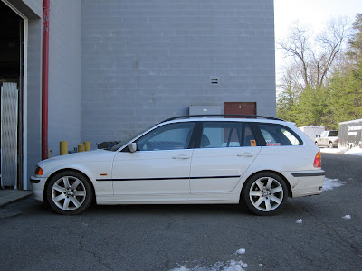

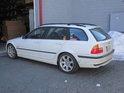

Here's photos of my wagon with ZHP coupe springs and Koni Yellows:
From a few weeks ago (snow still on the ground). Car is manual tranny since the total vehicle weight might make a difference.
I don't have anything to really compare the ride to as the wagon was non-sport before. But even with a full load in the back, no real noticeable sagging.
Does that help?
wuzilla is offline   Reply With Quote
Does that help?
Looks great! I was hoping you had the ZHP shock absorbers on there as well since I don't feel like going aftermarket since I will only track it maybe once or twice a year.
