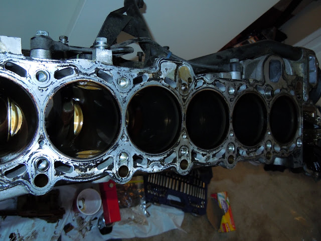

How do the cylinders look? Can they be honed and not change the bore?

You sir had a very close call with that engine.
Look at the spark plug electrodes....signs of detonation right there, which is the result of the oil contaminating the combustion chamber reducing the fuel octane.
The other stuff on the pistons and cylinder head is just excessive oil/carbon burned on. Nothing really to worry about.
Yes, I would still get the block bored and honed. The proper finish of the cylinder bores is not possible by just re-honing. They are actually oval right now...they need to made round again.

oh man....my friend just told me it was a big process to put the crank back in is that true?
Should i just bring it to them with the crank on?
It's no big deal. The main thing is just making sure the bearing clearances are right when re-assembling, but we can walk you through that with a torque wrench and "plastigauge".
BTW, the OEM main bearing cap bolts can be re-used...pretty much a standard grade 10 fastener.
Do you have new main and rod bearings?
I havnt bought any new parts yet.
Are you saying I can't reuse the rod cap bolts?
Sent from my ADR6400L using Bimmer App
Every book says to replace any cap-bolts except camshaft ones , however i would trust adam on this one
I will definitely.
So where do I start to remove this crank?
Remove rear gasket
Remove "breastplate"(chaincover)
Remove chain(s)
Remove chain sprocket
Remove main caps
Lift crank up , be careful it's heavy (50pounds)

Originally Posted by Pir4t View Post
Remove rear gasket
Remove chain(s)
Remove main caps
ummm my main pulley is still on.
