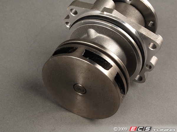

Does the Geba water pump have a composite impeller?
Edit: Photos look like a metal impeller

The Geba water pump in the kit featuring a stout metal impeller for improved longevity.

I can say good things about the geyba water pump and ECS, both are awesome the metal impaler is much more of a peace of mind than the poop plastic one on the OEM pump I pulled out... Car is running perfect, well, after I blew up my OEM water pulley and had to rush to BMW before closing to get another lol! ECS aluminum one is on my list as well as a new radiator seeing as i have a small crack. So... look forward to hearing from me again soon ECS
