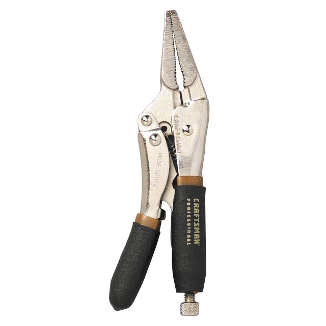

Yes, I'd go with long-nose locking pliers not the giant ones you've got, and you'd probably have room to turn it. I'd also consider a sacrificial TORX bit and some JB weld.
Then again I was referring to taking the bolt out without damaging it in the first place. Using any driver at an angle will easily round out the bolt. Take the intake boot off and you've got room to get a proper bit + ratchet and reduce the risk of rounding anything off to, well, zero.

And, yes, I suspect you'd have room to rotate them if you kept them on-axis with the bolt.
