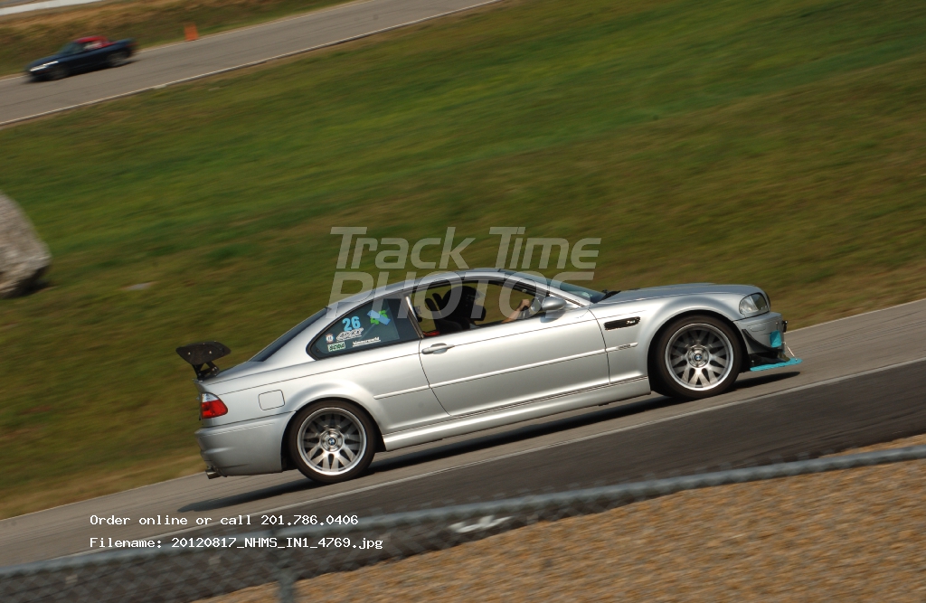

Well, NHMS went pretty well. I dual-drove the car with one of my friends and the car ran perfect without issue. I did almost go flying into the wall on the front straight leading out of turn 12 after a Mustang in front of me dropped coolant all over the track. One second I was going straight the next I was aimed at the wall - luckily I was able to bring the car back, but it shook me up. At the end of the day my lap times were the same as when I went there in May, but I wasn't pushing the car hard at all like I was in May, so there is certainly much more left. New pads and rotors going on soon and next event is Labor Day weekend at Watkins Glen. I finished the front splitter made of Lexan and attached the Bimmerworld Dive Planes. The rear wing is going to need adjustments made to it now and a rear diffuser is going in soon. Pictures below - and one of the M5.

Very nice build! What kind of times were you running at NHMS? My uncle runs a Spec Racer Ford in SCCA there once in a while.

1:24 was my best this time and back in May. However, there is certainly much more left in the car now, so I think a 1:20 is possible if I get into a groove. I wasn't even squealing the tires this time

Nice update! Looking forward to more updates on the races. Like you said, seems like you have more to.squeeze out if the tires weren't even talking back.
Both cars are sexy!

Surely you can get it faster than that with practice! A spec Miata runs about a 1:20 around there if you were running the oval in 1 and 2! It's hard to get used to the speeds involved and the braking distances
