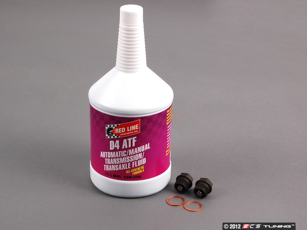

Our fluid of choice for the E46 transfer case is RedLine D4, also when changing the fluids in the case it's suggested to also replace the drain and fill plugs as well as the washers on them, I have a kit available HERE which makes it a one stop shop.
