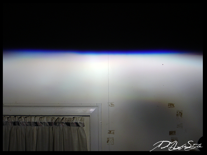

has anyone on here modded their hid's (swapping out lenses, bend shields, using washers to get a cleaner cut off line) I heard e46's projectors sucks compared to other oem manufacturers. Wondering has anyone done it and what are your results? heres some example i found online. the this pic is an E46 with ECE lens (its pretty much clear all around the lens, my cars hid len's has this split line through the middle i heard they are E46 BOSCH DOT lens)

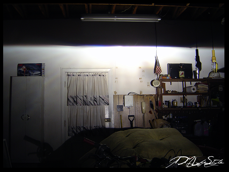

Now this is the same projector using washers to increase the distance from the lens to the shield and bulb, using 3 washers
and now with 4 washers
I also read some where that 330ix has the better lens of the e46's they dont have the split line in the middle and their cut off line is cleaner. They use ZKW lens, which are better than ECE ones. I have a 02 330ci and the cut off like looks like **** compared to these pics.

The horizontal line you see in the projector has nothing to do with whether it's a 'good' or 'bad' projector. The horizontal line is on the bi-xenon projectors, no line equals single-xenon.

where'd the stagger go? did this guy set up his lights to blind oncoming traffic?

I wish i could answer all your questions, But I'm still trying to research this. For all you who are wondering why the light is pointed so high. The person who took this pic has the Hid Projector/lens out of the headlight housing they tweaked it using washers shined it against the wall and took some pics and tweaked it more and took some more. With the reference to the bi-xenon and single xenon i'm not sure. I'm sorta surprise no one has brought this up in the forum. I did a search and couldnt find anything in here. Check out http://www.hidplanet.com/forums theres alot of stuff about modding hids.

Those pics are from HIDplanet.com right? They are not ECEs, they are all E46 DOT bi-xenons. An ECE single beam has a slope cutoff like below:

you can make it straight. it requires cutting the shield straight. extremely hard to do. even a small mistake shows up when the xenon is against. it. bending it back make the cutoff sharper, but only to a certain point. using the washer mod adds color, but will eventually make the cutoff fuzzier.

This is with 19 washers
