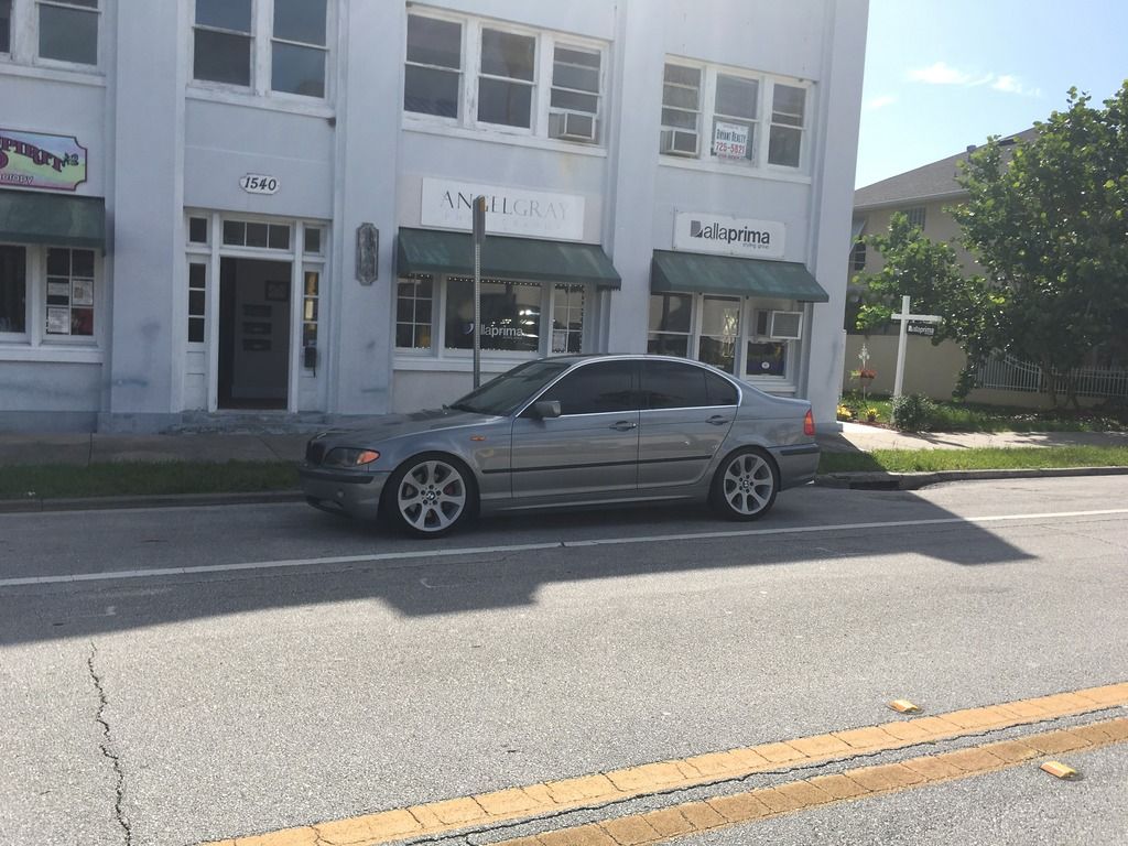

Pic as of Dec 2014
And current pic as of Jan 4th 2015 - Rang in the new year with application of some mods I had built up.
Current Pic as of April 2015:
Current pic 8/17/2015
Current Pic as of April 2016:
Current Pic as of July 2016 - finally looking like something I would own, ALOT of work into it at this point in time
Current as of August 2016
