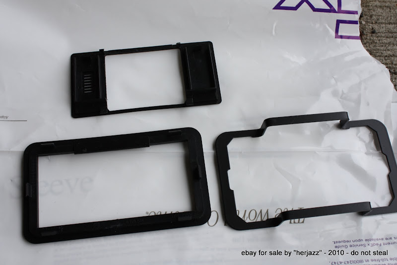

well, i sold my car and i took out the transmitter. so was selling the stock trim piece now and took photos of it (FYI, i already sold it on eBay). notice (see the photos) that it not only has the correct centered cutout for the homelink unit, but also a metal frame on the other side that stabilizes the trim piece and also hold the homelink unit there.
Photo detail of it:

I've been getting a few message about the OEM Homelink mounting "kit" that I posted above. It was so long ago (bought it in 2001 when I bought my car) I don't remember much about it. I know I ordered it from a BMW dealer here in the USA so it should be an OEM and available part.
If you look at my photo here: https://picasaweb.google.com/lh/phot...eat=directlink
==> The part number there says 8 171 514 -- maybe you can try looking that up??
