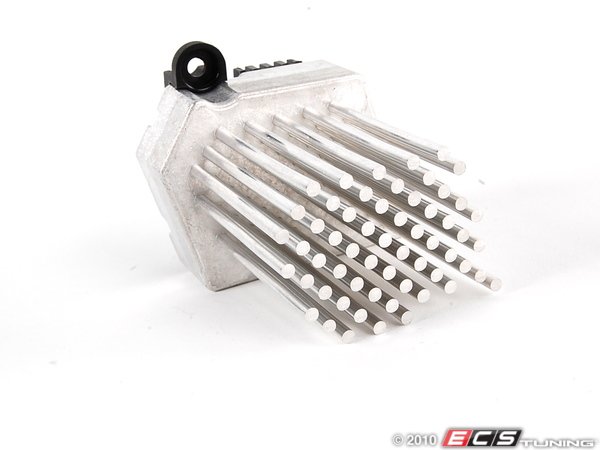

Might want to check out your Blower Motor Resistor...
We have replacement units available if you are in need of the part...
Click HERE to order or for more information.

From many years of personal experience with E46s when a blower motor resistor goes bad it does not matter whether or not the blower is off or not, it will run when it wants to. Usually creating a high whining noise (your problem). I understand you are not in need of the motor, thus the suggestion of the resistor.
I appreciate your honesty, however there is complete relevance in the post, as it deals directly with your specific problem.
I do wish you well in your search to fix your problem.
