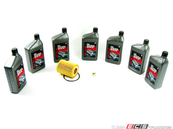

We have created a all in one service kits the include everything needed to complete your oil service...
*photo for reference only
