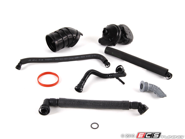

We have complete multi level kits available for a full system maintenance.
Ok Joe,
What's that little grey pipe thing in your picture? Cause that don't go on an E46.
