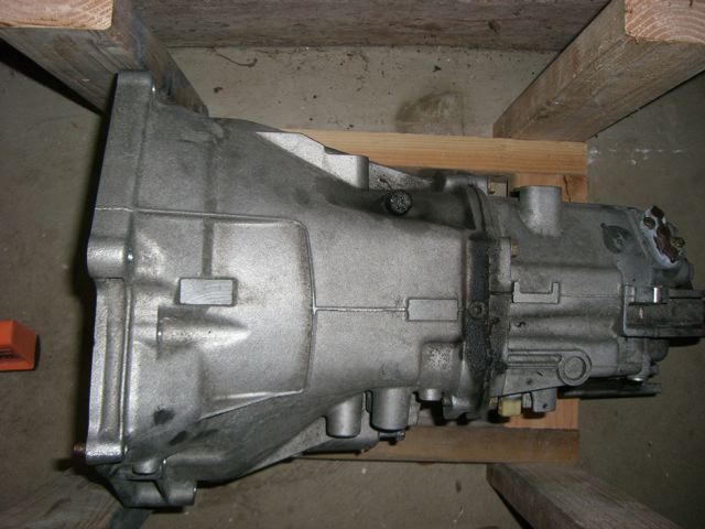

ok, realoem.com has this image
i've got something going on between the #1 and #2 bolts on the above picture. i've got #6 out, so it's not that.
i swear i don't see any more torx bolts on my transmission. i see 2 internal torx bolts (look like this)
that MAY be holding the starter on (located between #1 and #2 in reference to above picture), but they're almost impossible to get to, and impossible to get a good grip on. i'll see if i can get a picture.
thanks again mate.

1 am, in pj's and slippers, beer in hand, i go climbing under the car to get pics.
#11 does not have a head to it. and i can't see where the hell it comes from (starter?) also, x & y are pictured. they are torx, but NOT like the others (they are internal, like i pictured in my previous post). do i TRY to remove those (looks difficult).
oh, and #4 is NOT torx. it's a bolt that holds something on to transmission (wires?). just an fyi for anyone attempting this.
everything went well up to this point ... so close, and yet ...

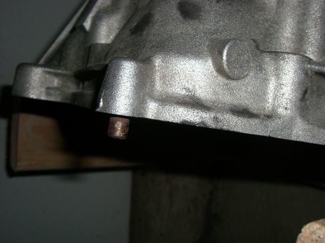

out!
this helped. (pneumatic chisel. put it beeween the 2 parts to separate and hit the go button. it went through like butter (this after about 5 hours of research, and many failed attempts at prying it apart with various tools and one big-ass screwdriver.)
the little monkey that caused all this trouble (dowel pin).
oh yeah, second little tip for pulling the trans out. engine must be tilted backwards a bit, we know that. but you can't simply just pull it off, you have to rotate it counter-clockwise a few degrees to get it to clear the underside of the car. this also caused us some trouble until we figured it out.
