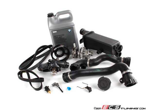

Prevent cooling issues and take service of your cooling system one step further with an ECS Tuning Level 2 Cooling System Maintenance Kit. The experts at ECS have identified all of the common parts that fail on a BMW and included them all in this convenient kit.
BMW has been designing notoriously failure-prone cooling systems since the late 1980s. The coolant capacity in most BMW engines is not sufficient to accommodate any driving or overheating near red zone temperatures. After the gauge reaches this critical area, it is common for thousands of dollars in damage to occur.
Stop the problems before they arise. If you vehicle has 60,000 miles or more, replace all of these components to ensure that your vehicle stays healthy. To keep everything in top order, continue to replace these components at 60,000 mile intervals. Water pump failure, cracked plastic housings, and expansion tank leaks will not be a concern once all these problem parts are replaced.
