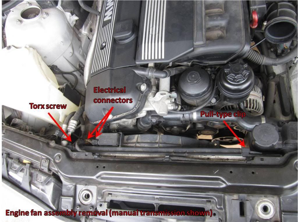

5. Lift out engine fan assembly and remove both belts (marking the orientation of the belts)

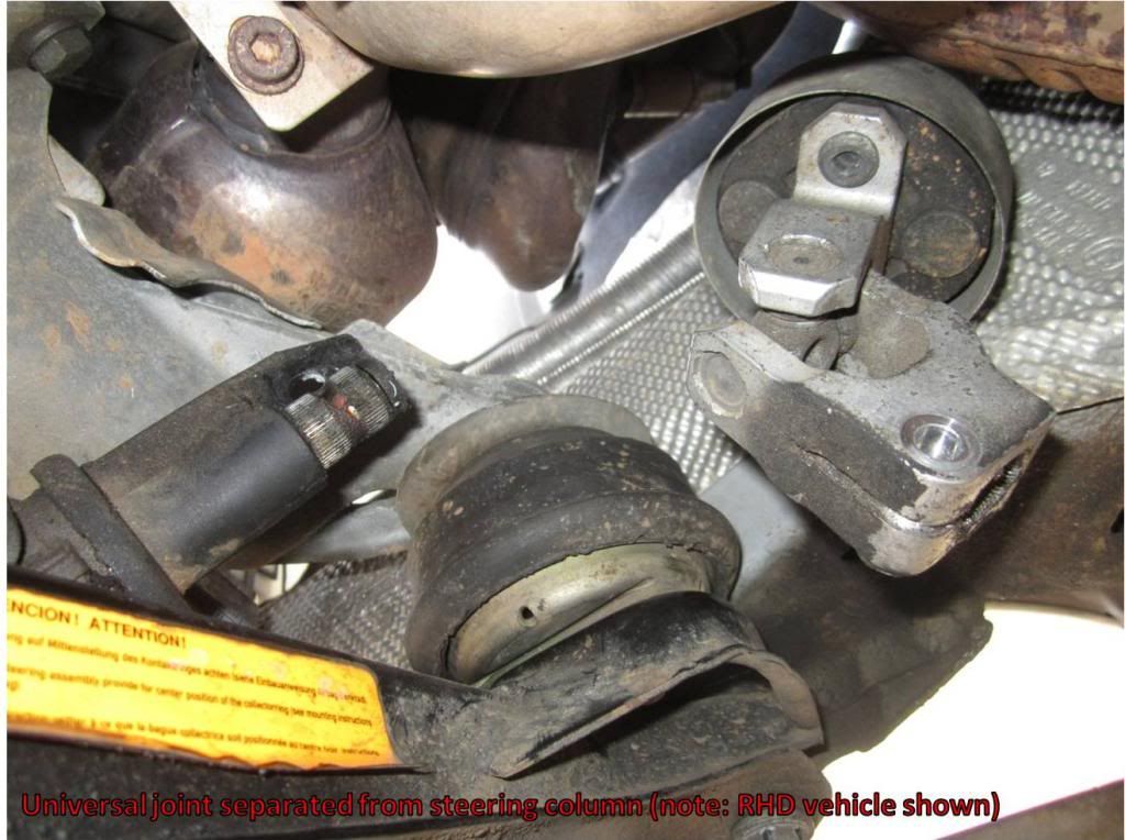

10. Ensure that the steering wheel is centered. Take the key out of the ignition to prevent the steering wheel from being moved accidentally. Working under the car, carefully mark the position of the steering column shaft in the steering rack universal joint (see reassembly note (viii) on why this is important). Remove the (1 x ) torx screw and separate the shaft from the steering rack.

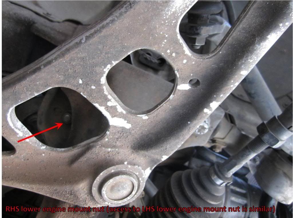

12. Remove the (2 x ) lower engine mount fastening nuts

15. Support the suspension sub-frame from below using a jack. Remove the (4 x ) sub-frame mounting bolts and lower the suspension. I lowered the sub-frame assembly (along with the steering rack) onto a pair of 5L oil bottles. Try to pull the sub-frame assembly as far forward as possible, so that it's clear of the oil pan.
Side note: This is where my procedure differs a little from the Bentley manual. In the manual, you're instructed to remove the control arm mounting nuts located on the sub-frame. This is no easy feat, while the sub-frame is still bolted to the car. I found that even if the control arms are left connected to the sub-frame, there is enough slack to lower the sub-frame assembly clear of the oil pan.

(viii) It is very important that you re-align the steering column shaft keyway exactly into its original position. Once the steering column shaft is disconnected, it doesn't take a lot of force to change the steering angle (on the steering rack side). Getting it wrong by even 1 notch will result in your steering wheel being tilted off centre by 10 to 15 degrees.
