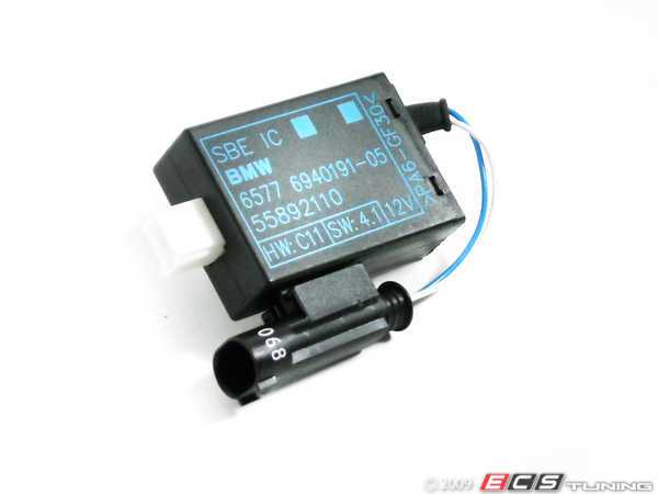

OCCUPANCY SENSOR AND AIRBAG SEAT SENSOR EXPLANATION:
Information that I have gathered from other forum members here that explained how things work. (Thanks guys!)
OPTION 1:
If you are like me and prefer to have new parts for peace of mind, You can buy The airbag seat sensor and occupancy sensor from ECS Tuning. I decided to do this since I did not want to salvage these 2 parts from my OEM passenger seat, lessen the chances of the old airbag and occupancy sensor failing since they are old already, and make sure that everything is right and safe. Only downside is that you have to spend about $210 for the two parts. Other than that, it will just work exactly as the OEM seat did. It will get rid of the Airbag light, recognize that there is weight in the passenger seat when occupied which will automatically turn the passenger airbag on, and off when the seat is unoccupied.
OPTION 2:
Another option is to extract the airbag seat sensor and occupancy sensor from your old OEM passenger seat and use them on your race seats. This is great because you basically do not have to spend anything. It might just be time consuming and you risk damaging the parts if you are not careful removing them. Just like option 1, this will work like the OEM seat that you previously had. It will get rid of the Airbag light, recognize that there is weight in the passenger seat when occupied which will automatically turn the passenger airbag on, and off when the seat is unoccupied.
OPTION 3:
Buy an occupancy seat sensor bypass from ebay or do the resistor mod. Both options are cheap and will cost you less the $20. What the bypass or the resistor mod does is that it emulates and recognizes that the passenger seat is occupied even though there is no one sitting on it. Therefore, turning your passenger airbag on all the time. Only problem with this is that if you get in a wreck, even if you do not have a passenger on the seat, the airbag in your passenger seat will still engage. Both driver and passenger airbags will deploy and instead of just replacing the driver side, now you need to replace the passenger airbag as well. Some people are okay with it so it is really up to you to decide. But there is really no guarantee if the airbags are on all the time unless you have a tool to scan and check them with.

Some of the parts that I ordered got delivered today.
Base mounts from PLANTED and Occupancy sensor box and mat from ECS Tuning.
The RECARO SEATS are on their way to the shop to be re-upholstered.
BASE MOUNTS
OCCUPANCY SENSOR BOX AND MAT
