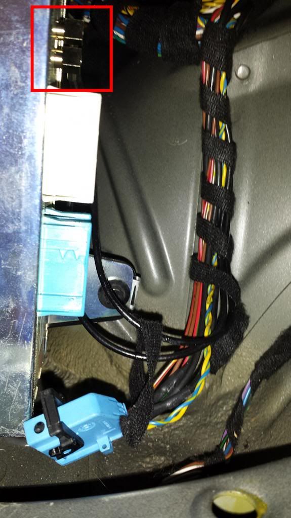

ok posting this hoping for answers. Board has been soldered up and seems to work ok, but i've hit a snag at the install into car phase.
1) i have the TV module, but i do not have a harness with a white plug? i have the blue plug, and from that harness springs 2 more cables that plug into individual spots on the back of the TV unit. The TV unit has a spot for the white plug, but yeah - no actual cable plugs into it. See photo below. When it's all connected i do have the television option and it does work (although you only get white noise).

this is the TV unit.
note: i dont have nav or a reverse camera. is this perhaps why no white harness?
